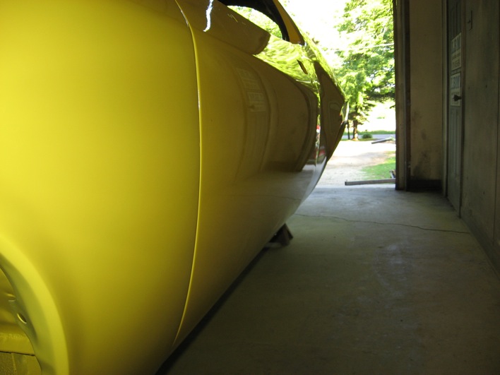

Yeah, I can't drink and then paint. If I have even one drink before I paint, I will screw it up. The Roadrunner pic's is before buffing it out. :penguins paint pixi
