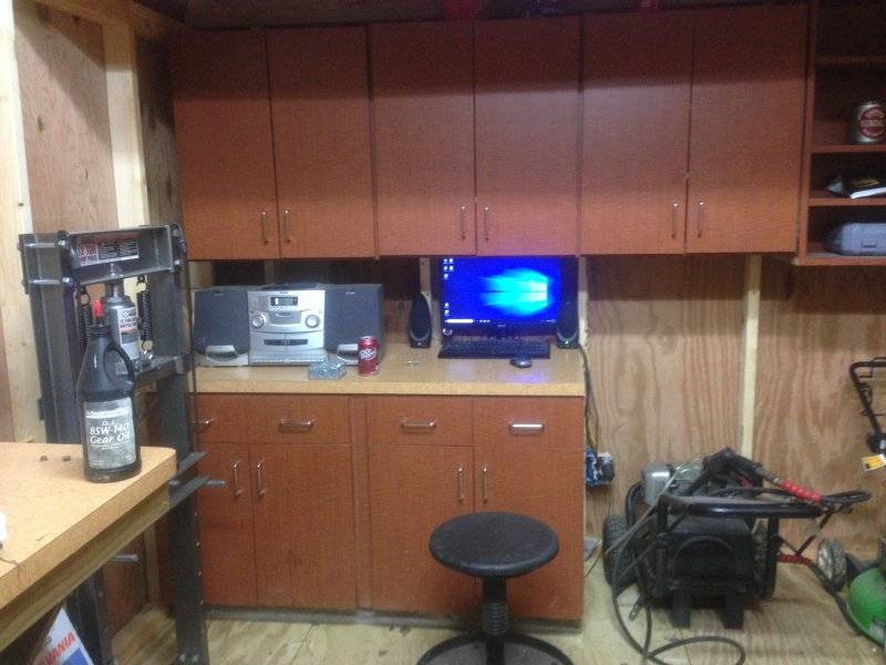

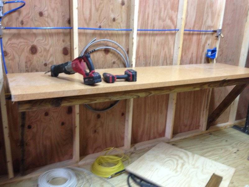

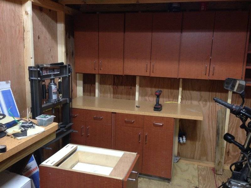

This was my shed when I first got it.
This is some of the stuff I added free cabinets from a job gut out.

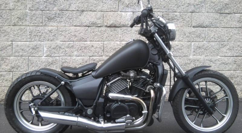

I think I have come up with a plan on the bike. Seen a couple of them done on the internet and I think they actually look pretty cool done as a bobber.
Whatever you do please do NOT put straight pipes on it. Those engines sound like craps...well, like big farts with straight pipes.
I planned on leaving the exhaust as is. But since it’s a V-twin it probably would sound too bad with straight pipes. Then again no intension on removing the pipes.
Trust me, the VT Hondas sound awful with straights. It's due to the crank configuration and the angle of the cylinders.
Yea I had no intentions of removing the exhaust. It would be like the first bobber picture. Those are full pipes.
