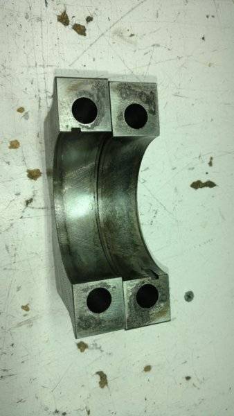

According to Wallace Racing calculator for ET and weight, 550. With an old school build...light pistons and Hemi rods, it showed cap walk after over 300 passes.
Can someone please explain to me what "cap walk" is?

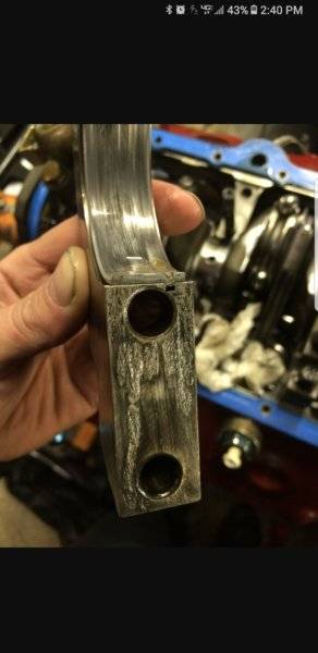

Some call it cap bounce....it's when the main caps bounce or move (walk) due to the forces placed on them from combustion. The main caps actually move around during high stress conditions. Steel is flexible and bends and twists. Crankshaft harmonics is actually the crank flexing......rods bend. Heck, even the block flexes too.
So the holes in the caps that fit over the bolts actually get elongated? Or do they remain the same and the cap itself just seems warped?
Here are a couple of InterWeb pix if that helps
The surface on the cap and block shows fretting or material loss. The holes in the cap are already slightly larger than the bolts or studs diameter. Clamping force is supposed to hold them against the block.

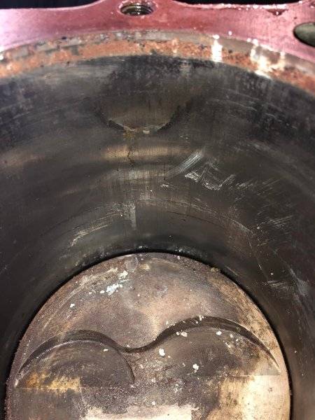

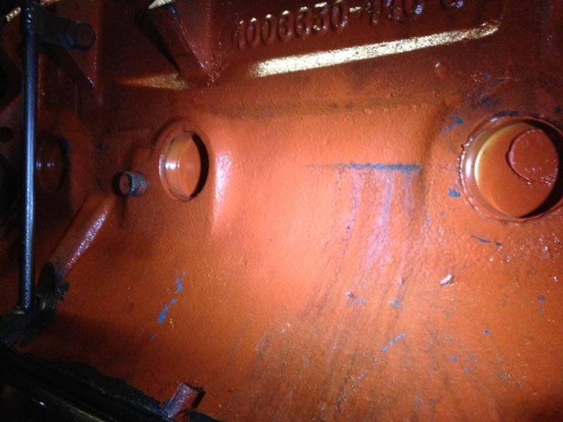

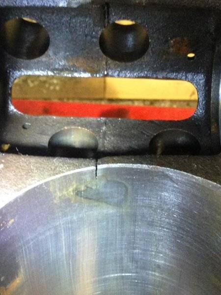

Since writing up this thread, I've gone through 3 blocks. All my engines ran 6.30's @ 107 mph (1/8 mile) in a 3550 lb car. All block failures were because of cracks. All blocks had a girdle installed and the 2nd and 3rd block was filled about an inch or so above the freeze plug line with Hardblok.
Block #1 developed a crack in the middle of the freeze plugs on the drivers side.
Block #2 had a massive cylinder crack and a strange "hotspot", I believe this was just a old block issue... Had 3 passes on it.
Block #3 was sitting for about 3 years, that ended up being a small crack in the cylinder wall just above where the Hardblok stopped.

If they sonic good Block #1 water jacket crack is an easy stich pin repair. Block #3 gets a sleeve.
Doug
Doug
