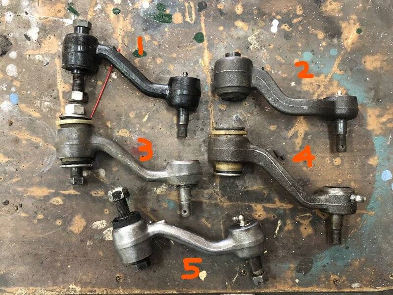

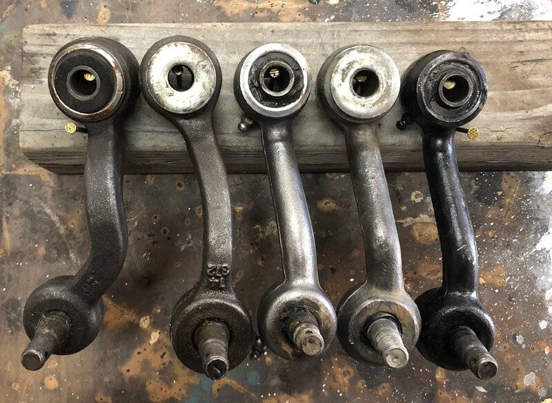

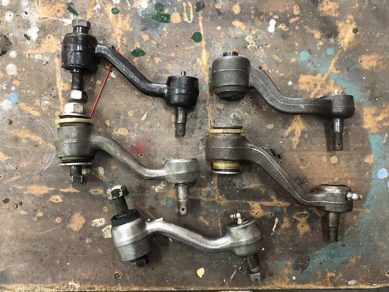

The Idler arms that I have here vary a LOT in design.
They all have the same offset but I think that I like #4 best based on the robust shape, the nylon bushings and the Zerk fitting to grease it.
I'll trial fit the #4 Idler and if it lines up right, it will remain.

Where did you buy the #4 arm? my iddler arm grease fitting (90 degree) hits my torsion bar. 68 charger 383 engine
Where did you buy the #4 arm? my idler arm grease fitting (90 degree) hits my torsion bar. 68 charger 383 engine
I don't know.
I have picked up parts from friends and others that have cleared out their garages, shops and sheds. I should mark these parts when I get them just to kn0w exactly what they are.

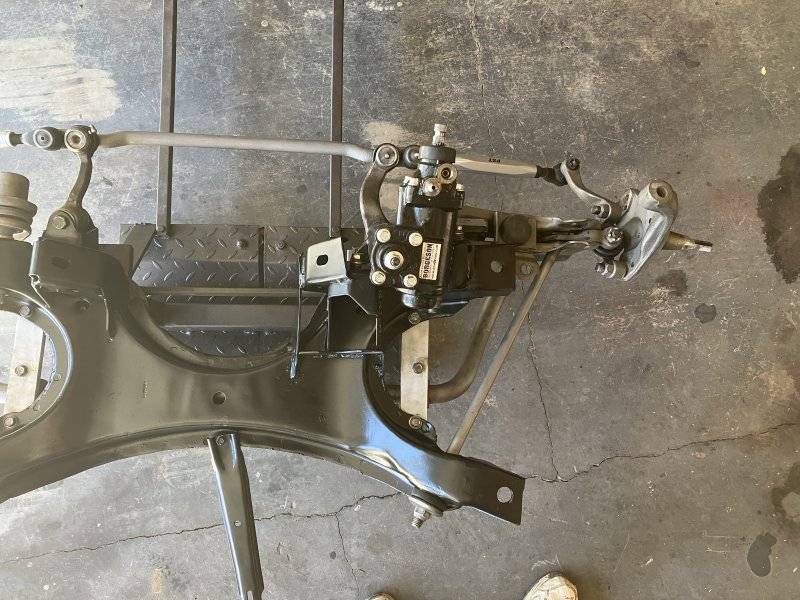

Here is an overhead shot:
You can see the clockwise angle to the steering box and to a degree, the center link has some angle to it too. It looks as if the idler arm is longer than the Pitman, pushing the center link rearward slightly more on that side. I can attest that the car aligns fine and tracks as straight as anything I've driven. There have been no tire wear issues I've noticed.
This K member may be from a Barracuda or 71-72 B body. I've picked up lots of parts over the years. I modified this one 10+ years ago with gussets and seam welding. Back then, I didn't know about the steering box angle being different so I just swapped it in.
