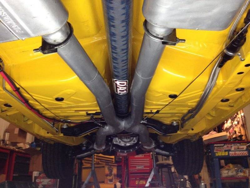

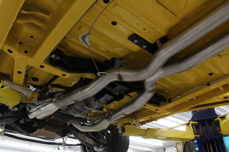

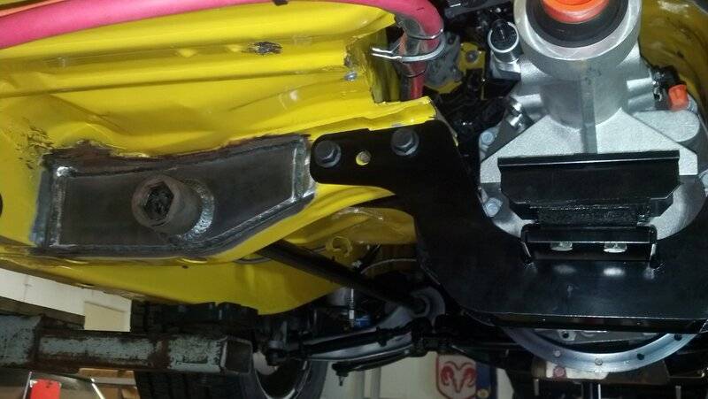

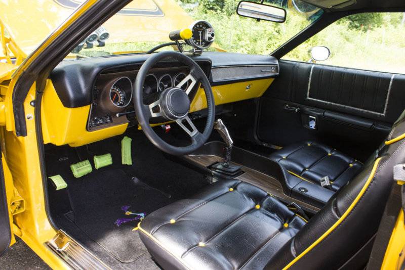

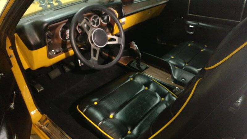

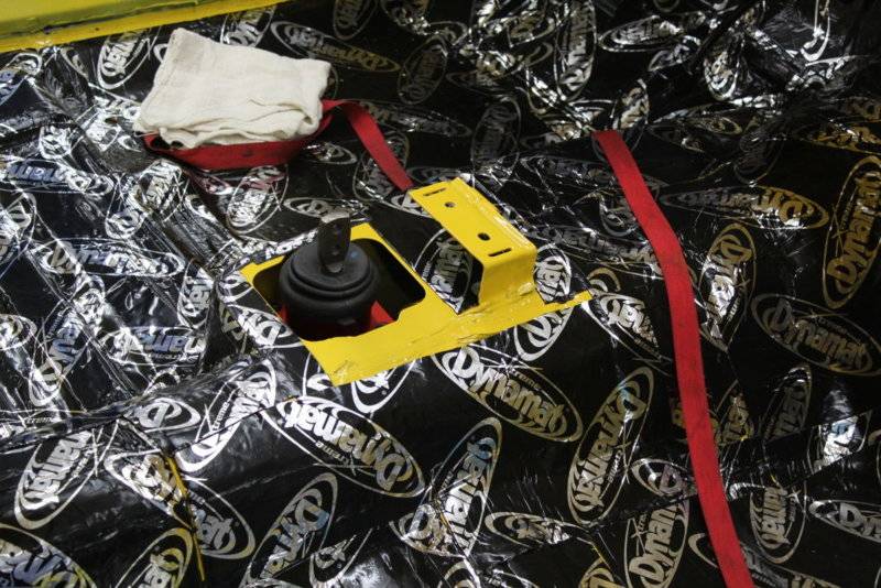

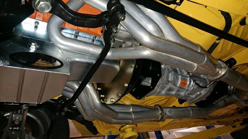

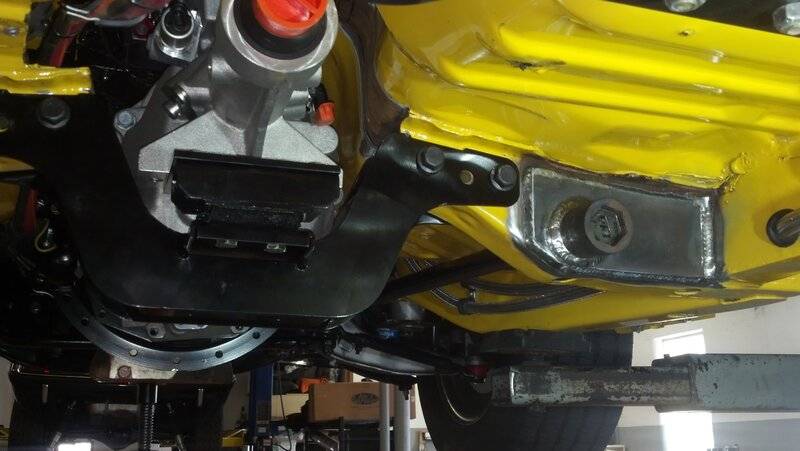

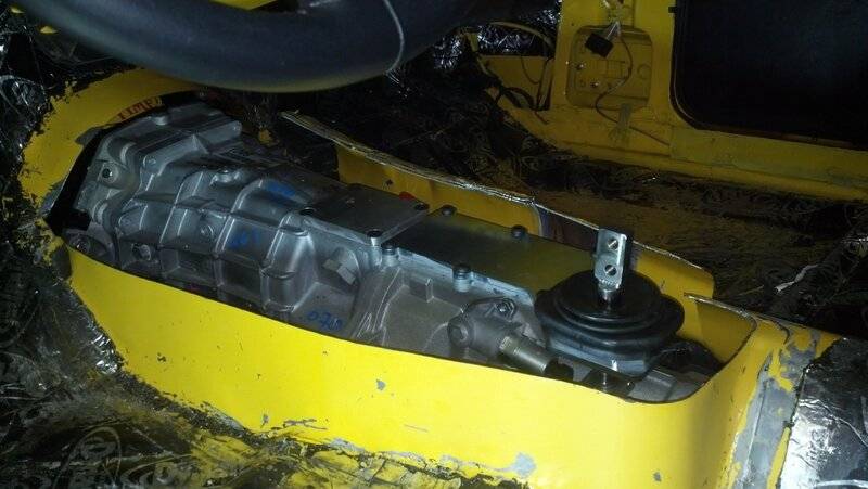

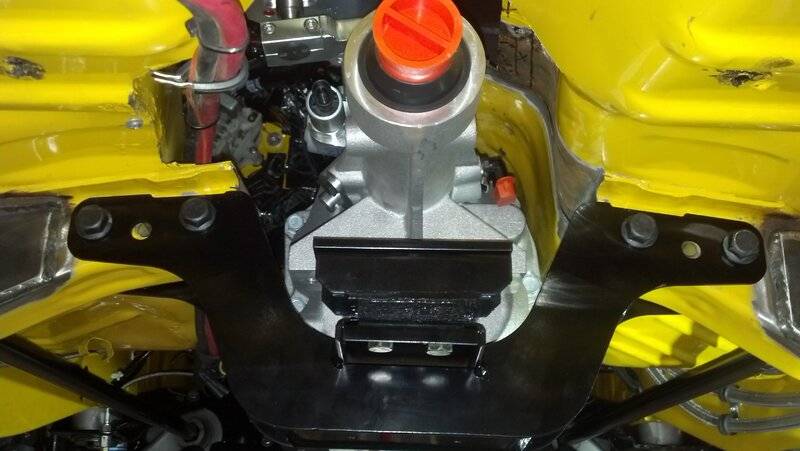

Yes it’s all finished. It turned into a really big project. It requires a lot more modifications to install one of these transmissions in a 73-74 due to the torsion bar crossmember being in the way. That crossmember needs to be removed and the chassis needs to be modified so the bars mount into the chassis instead of the crossmember. I’m sure you could make the transmission you found work but not all T56’s are configured the same. The one from SST is designed to fit in B & E bodies. The shifter location is unique. You will find that the softer on the trans you found is located quite a bit further forward. Here are a few pics of my install
