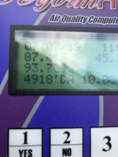

The day was great today. Air was not good though, by mid afternoon it was up to 4200' The 64 worked great, consistent 135, 136 60's @ 10.09's. Only got 2 test runs and into eliminations, met up with Wookie and that was it. I cut a .020 red and he went on for the win. Actually, on this run against Wooks, my time slip said that I ran a 9.66! And no MPH! What the hell. Regardless, I lost the race before it started.

Some pretty crappy air this morning.

Sunday was a crazy day though. Air was 4800-4900 from
Mid morning on.
