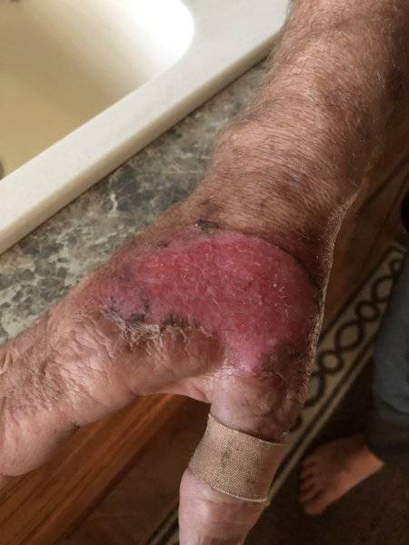

The next scheduled meet for me is July 26 / 27th. Will be a 3-week spread since the last time out for me. But the time is being put to good use. I've been able to refinish the garage foor. I had a dumbass moment though and burnt the **** out of my right hand with pure lye crystals. Skin doesn't grow back as fast as it used to I'm finding. Friends are saying this is a good reason to upgrade to an air shifter!

I've used Lye crystals lots for stripping anodizing off of parts over the years. I was using it this time to wash the garage floor prior to paint. Just got laxed, forgot about mixing procedures. Had my hand under the cold water within seconds thank goodness. Guys, don't be a dumbass like me, it hurts.
that's a burn type wound get some of that cream that has silver in it. get some ssd or silver sulfadiazine cream. its good for that type of burn.
Yep, that's what I'm using on it and it's coming along good. Won't look the purtiest but cosmetics is over rated anyhow.

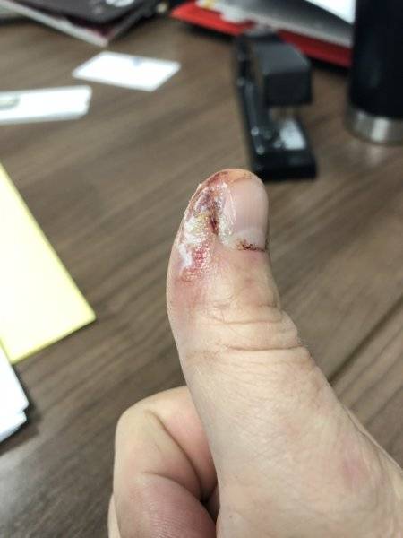

Last winter when I was laying the laminate countertop in my shop, I got my thumb into the router..... yuk!

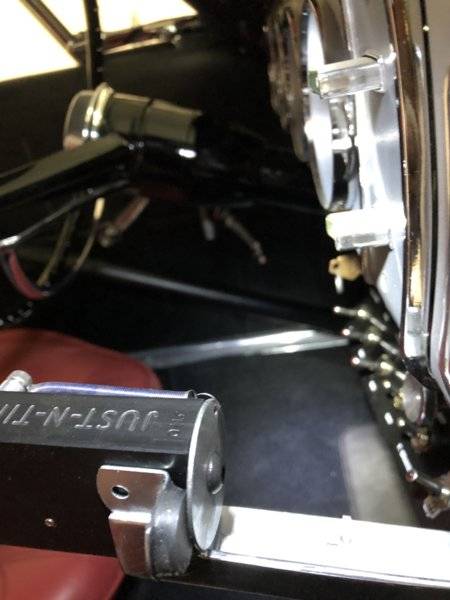

In the meantime I've made some mods to my trans brake button to eliminate the bounce that I was experiencing. Check it out.
I replaced the aluminum washer on the rear with a thin modified steel one. Then I attached a small magnet to the switch body. Now when the button pops out, it sticks...
What was happening was that the button would bounce once reaching the end of it's travel and it would effect reaction time. Depending how I let go of the button would change the amount of bounce too.
I was telling a fellow racer that it seemed like my trans brake was not releasing properly sometimes. He recalled hearing about a button problem once, I checked mine and sure enough. When using a lighter spring supplied in the kit this can happen.

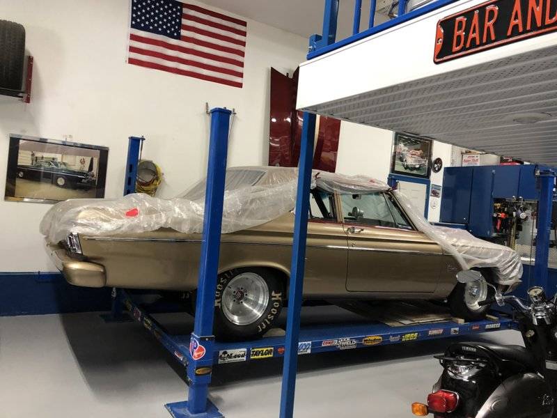

Also raised the rear ride height an inch, readjusted pinion angle, will see if there's any change in 60'. Rear tires now can come off without unbolting the shocks too.
Another week to wait... 58516897846__EC1E1AF0-3534-4AD5-AAA3-D4332996F2EA.JPG
