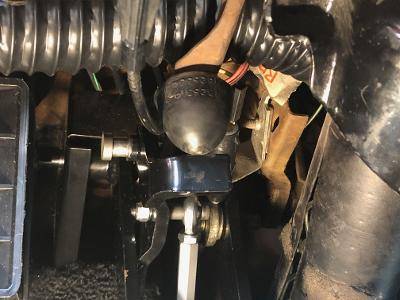

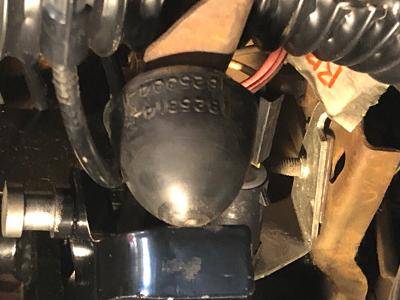

I did put in a clutch pedal UP-stop bumper.
It is an upper control arm bump stop for A-B and E body cars.
Cheap and effective.

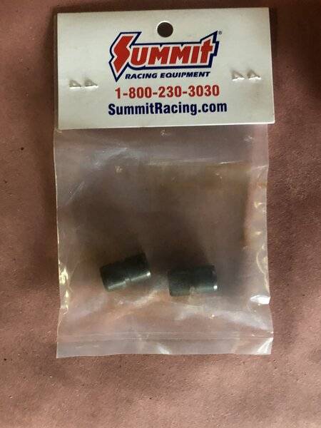

o be perfectly centered, it needs to shift .0135 to the LEFT. The offset dowels that I bought are the ones with the smallest offset, .007. I need to call Summit and order the next size up.
I'm about to order this .007 offset dowel part unless you want to sell yours Kern?
Hello there, 68....
You don't want these. Look at pins from RobbMCPerformance. Their dowel pins are far superior. These Summit pins are like a 3 speed compared to a 5 speed.
