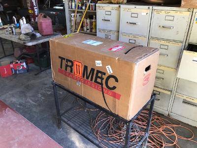

One of the stumbling blocks for making a leap like this has been the cost. Looking at this from a "it will get better mileage" perspective is not at all sensible. I'll probably never drive it enough to save that much gas money even if it were to get 100 mpg after this swap.
For awhile, I actually considered the 4 speed automatic swap. One reason that I dismissed that is that IF I were going to spend $6000 or more, I wanted a more dramatic change in the car. An automatic with one more gear didn't seem dramatic enough. The 727 works great, it just needed another gear. A manual trans though....Now THAT is a dramatic difference in the driving experience.View attachment 1050941
