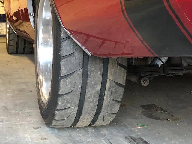

I'm getting better at shifting without mistakes. I don't dump the clutch from a dead stop but I do let it engage then hammer it pretty good. The "Summer Compound" 100 TW tires are not drag race tires by any stretch. They don't smoke much but they do spin pretty good. I had it up almost 100 on Saturday on the way to a car show. Rowing the gears is so much more fun than putting it in drive and letting the transmission shift for itself.
I wonder how much abuse the 8 3/4" axle will take before it starts to make trouble. I don't want the weight of the Dana 60. I may consider a 9 1/4" axle if I can find a set of 3.55 or 3.73 gears for one. I'd obviously need a car axle to have a pinion snubber. This means looking for a C body. I have a 3.55 9 1/4" axle in my 2007 Ram truck but I don't know what years the gears interchange.
