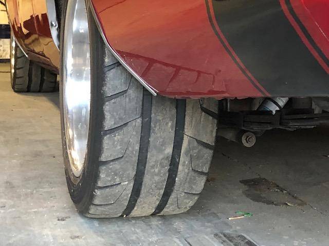

It's also the spacing of the tread grooves. Mostly they are unequal and random in size - this reduces drone on the highway. Hard to see if yours have different sizes.Generally, the lower the treadwear rating, the fewer the tread grooves. A slick would produce far less noise than an all season radial.
My tires have a rating of 100.
KD have you tried different tires to reduce "road" noise?

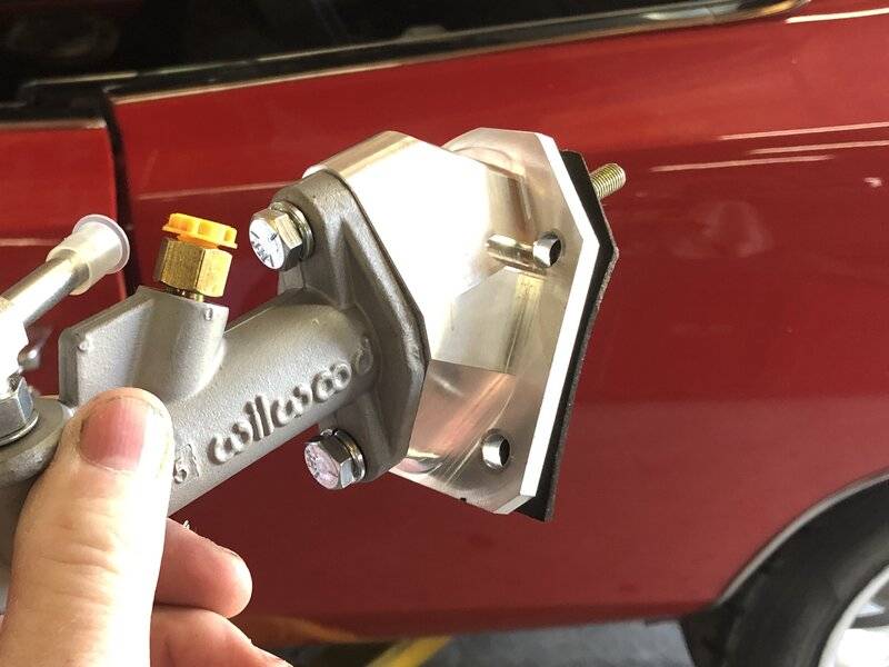

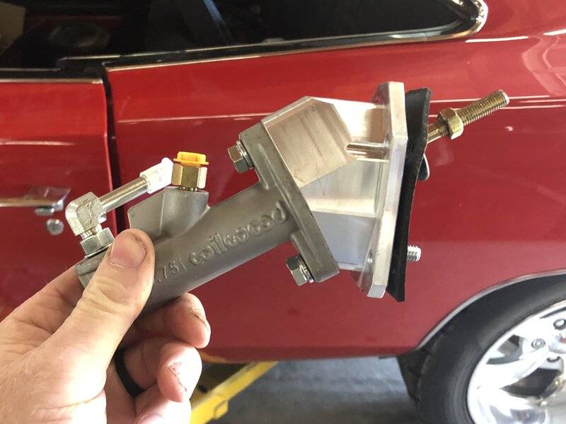

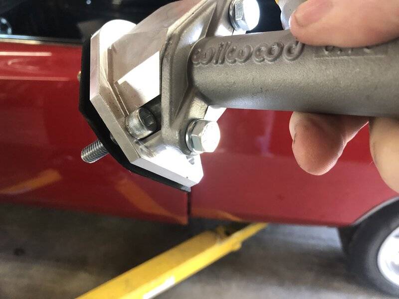

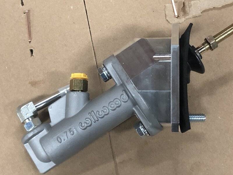

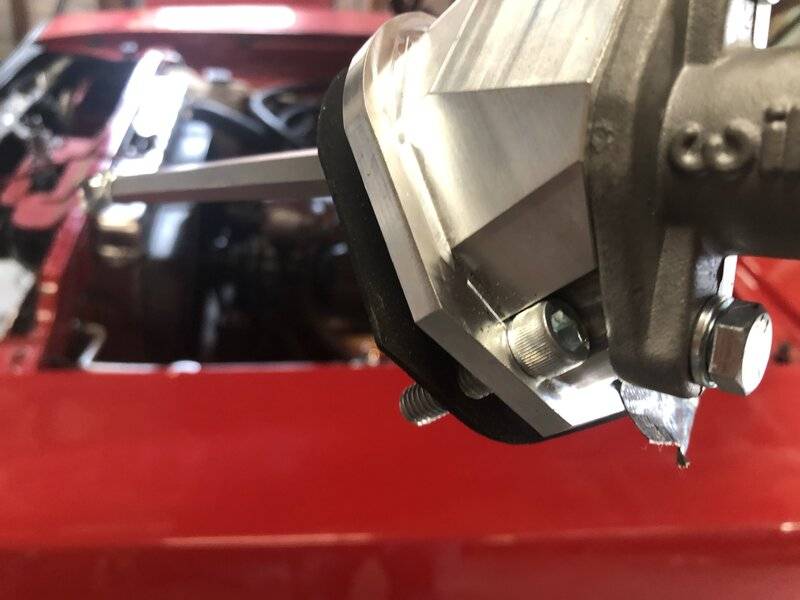

I think it would had been easier to have the adapter threaded, and the bolts going from inside the car into the engine compartment.The clutch master cylinder is a Wilwood unit with an adapter to fit the Mopar floor.
View attachment 1054610 View attachment 1054611 View attachment 1054612
It would be great to just place it against the firewall and drill. This not possible with the engine in place and those two right side holes are right up against the wheelwell anyway.
Oh, the lower left bolt?
Trapped under the body of the master cylinder. You can't just set it against the firewall. You have to remove the adapter and separate the two, then get the bolt out.

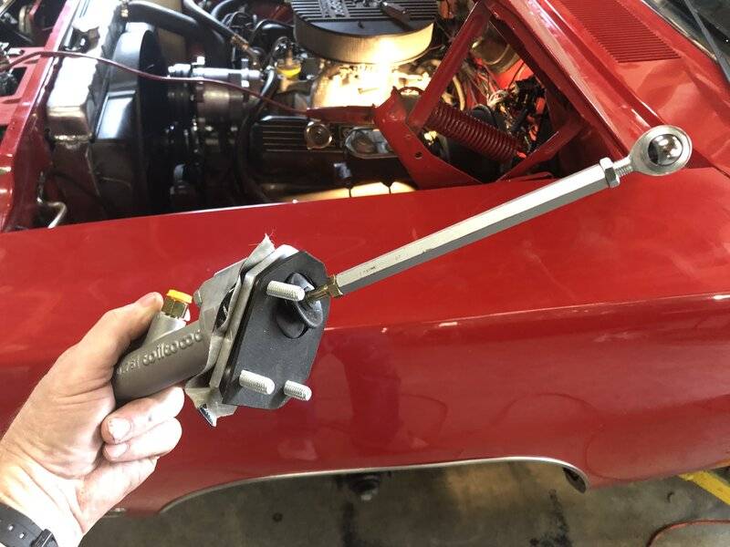

I attached the clutch pushrod....
