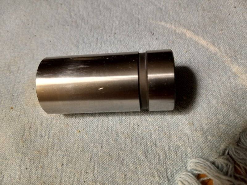

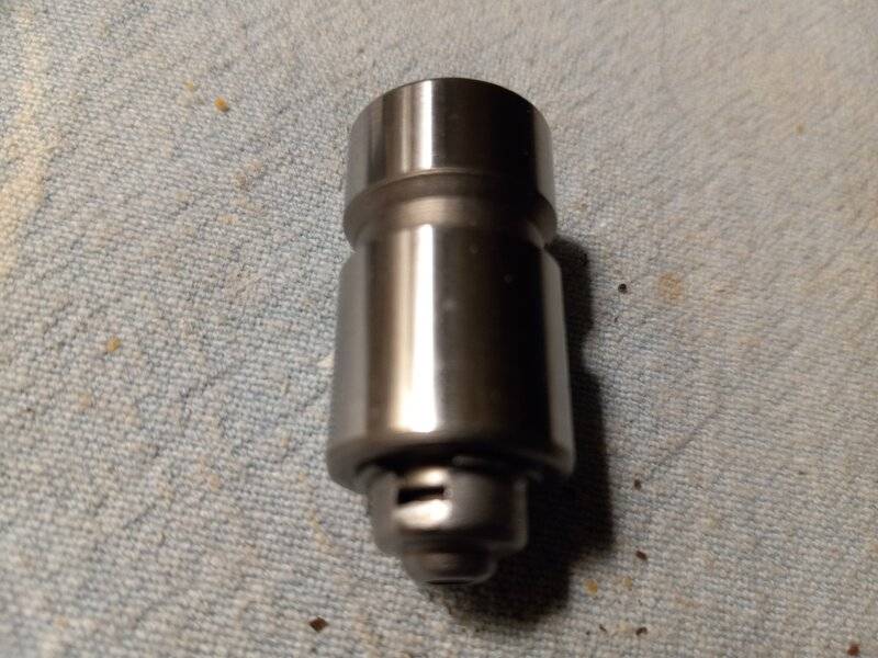

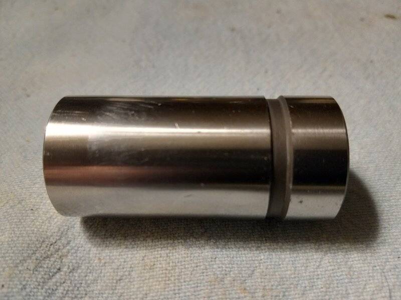

First lifter disassembled. Very fine verticle
scratches (almost like a burnish), with a
couple very small random scratches. Can't
feel them with a fingernail. Plunger,
and spring, both look good. I can't get the disc
to drop out. You can see it in the third pick.
It's almost like it's captured by the bottom
portion of the plunger, and I don't want to
destroy the lifter trying to get it out.
There was a very fine small amount of debris
in the bottom of the lifter barrel.
Should these be replaced? I realize the burnish
marks are evidence the lifter was not rotating
at initial start, but maybe started to rotate
once the oil got to it and the lifter pumped
up.. the face is pristine, bright mirror, with
zero scratches.

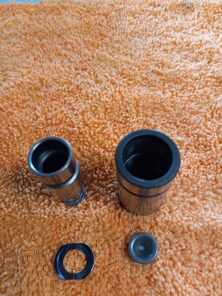

How about a pic of those odd lifter plunger retaining clips.
zero scratches.View attachment 1266975 View attachment 1266976 View attachment 1266977

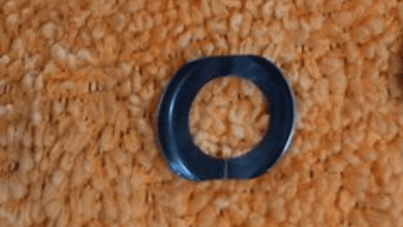

Is it just me or is the last picture of the lifter in this post not look right.
attachment 1266977
I suspected that’s what you had.
Those are designed to preload the plunger down about .025-.030, and then you would run basically “0” preload beyond that.
They are supposed to be used with an adjustable valvetrain.
I don’t think any other lifter “manufacturers” uses those besides Hylift Johnson.
They are denoted by an “R” suffix in the part number(with the Hylift Johnson numbering system).
And yes...... those retainers are basically one use only.
They can be replaced with the std wire clips or even True-arc style snap rings, but you lose the extra preload if you do that.
