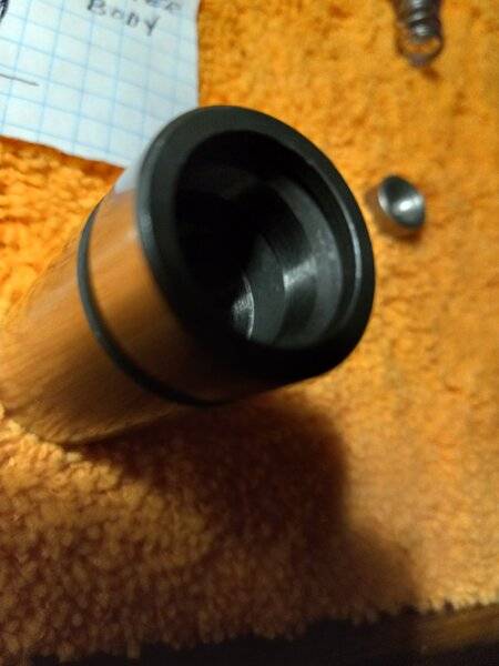

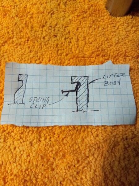

I don’t think you’re grasping the intent of those old lifters with the cup type retainer.
They are to be run with essentially “0” preload from the pushrod.
The plunger is preloaded by the retainer.
The purpose of that is if you float the valves, you can’t “pump the lifters up” and hang the valves open.
The plungers are already topped out.
Preloading them more doesn’t hurt anything, it just defeats the intent of the design.
You basically can’t check for coil bind/seal clearance with a hyd lifter, since it’s not fully pumped up when the engine isn’t running.
