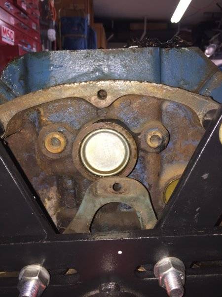

Water in all the cylinders?
Your freeze plugs are shot.
Yup I see that. Funny a few on the back looked new....
Looks like it was apart before with the orange silicon. I tore mine all the way down and had Dave put it back together. I could not justify doing it twice if I did it for what he charged to reassemble it to a long block.
Right thats what I am thinking. As much as a 408 would be really neat if this engine is good I am nit one to waste a good thing.
