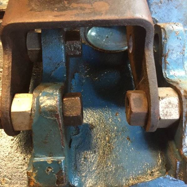

My drain plugs are more than just clogged. They look like they are completely blocked off. I tried to scrape, and even chistle out both sides but it looks like a solit metal plug. Also this engine has been out before as the motor mounts were made in Korea and one side used nuts as shims!

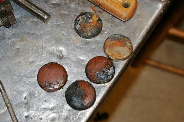

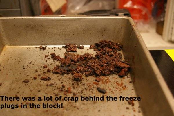

Yes the openings sometimes crust over! You should see what comes out of some blocks when replacing rusted/seeping freeze plugs! (I'll include a photo). Your mounts (pads) are probably Anchor Brand. It appears that several things were mickey-moused on your car by a previous owner or backyard mechanic friend.

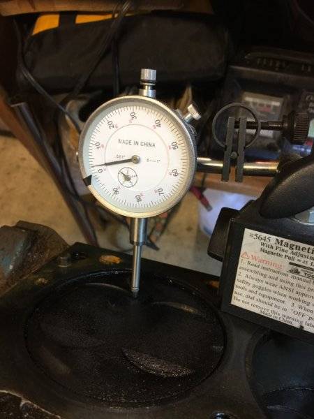

Not sure what you're hoping to conclude from the dial gauge readings. Really doesn't tell you much of anything. Unless you know that the rods and pistons are absolutely identical between the cyls you won't know if the deck is square to the crank. However, even knowing whether the deck is square to the crank or not won't have any bearing on the issue at hand.
Hi Steve thanks for the info! I used the disl indicator to finde TDC for each piston then took a vernier to measure depth. I understand what you are saying about the swuareness of the block but some folkes had asked. At this point I agree I am not going to be able to find the issue but its a darn strange thing......the plugs I noticed being wet were wet with coolant which is the only liquid Ican think of plus I know what coolant feels and smells like.
