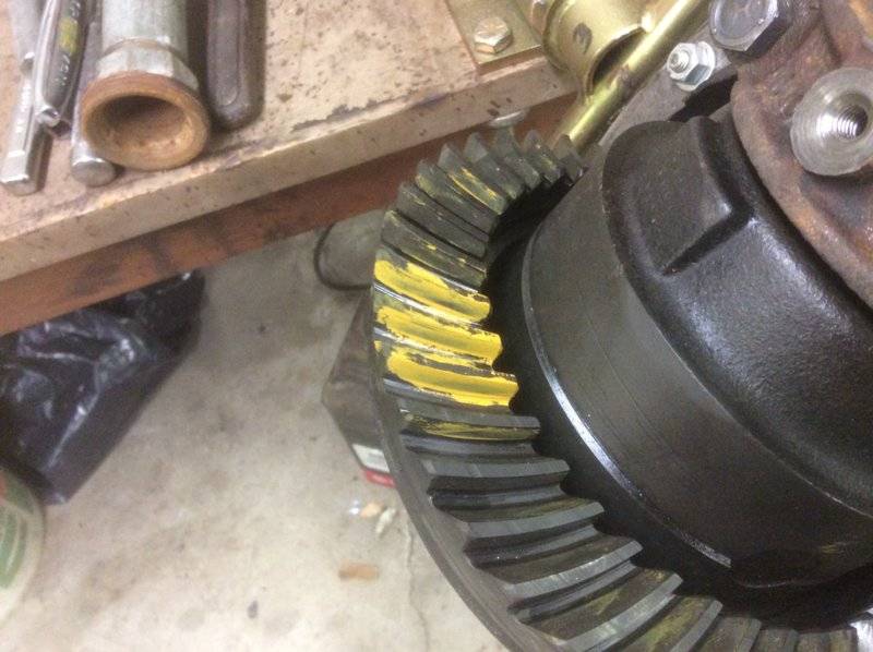

Fran,remember, set R&P no backlash; then screw in rt.side adjuster for the lash. Have fun, Jeff. Gotta have a little tension on the housing.

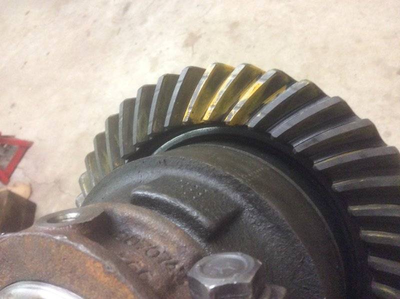

SM says have backlash at .0005 to .0015 then turn tooth side so b-lash is .006 to .008. My 80k mile gears had .011 and a good pattern. Sooo my plan was set it at.004 then turn tooth side adjuster until I get .010 or .011 b-lash.

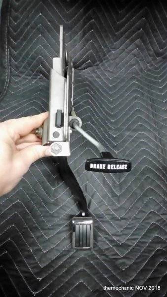

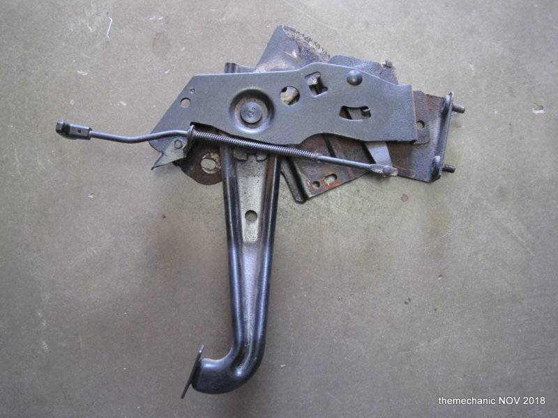

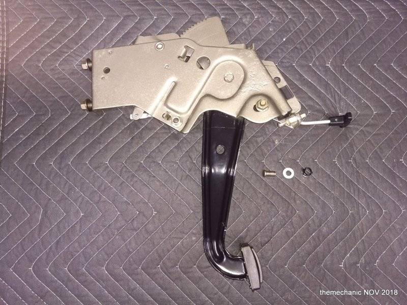

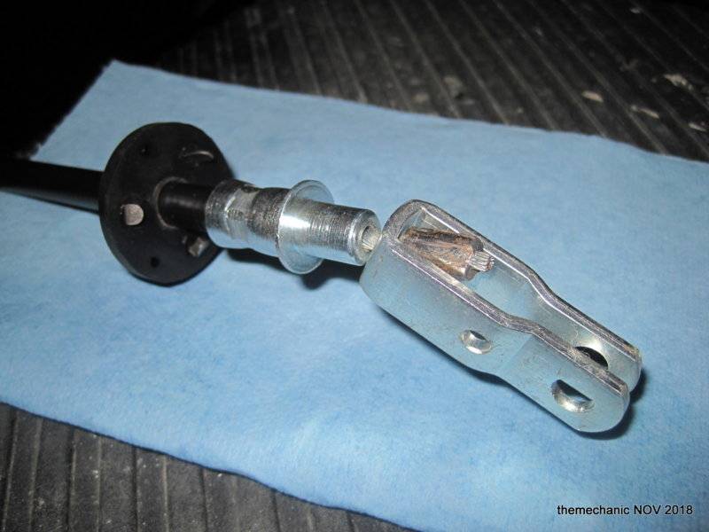

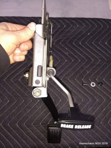

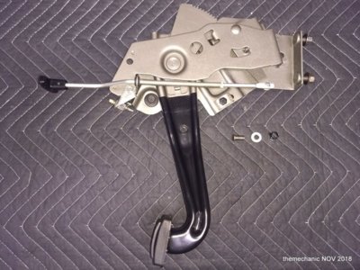

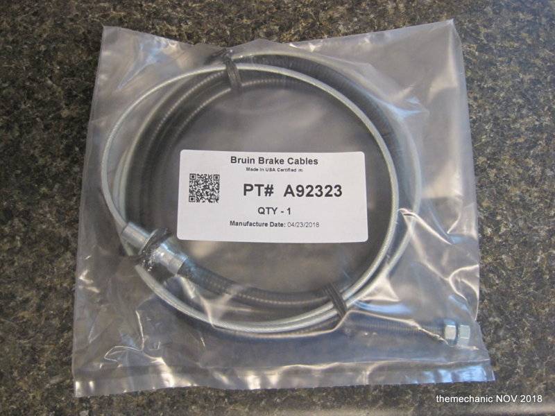

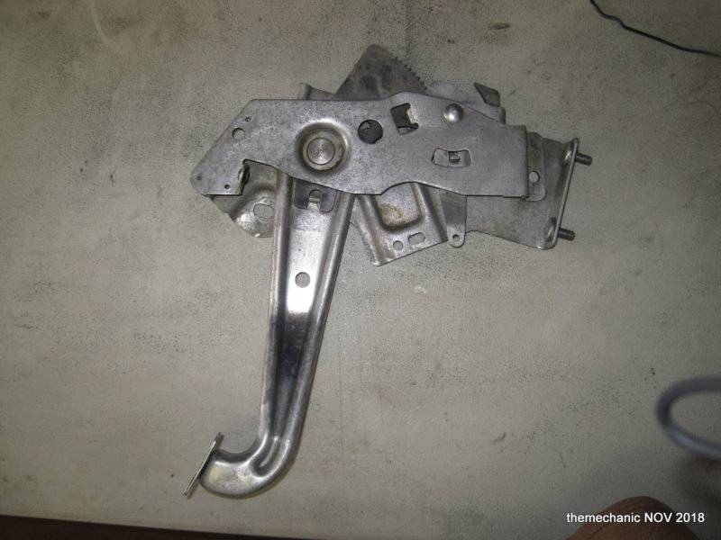

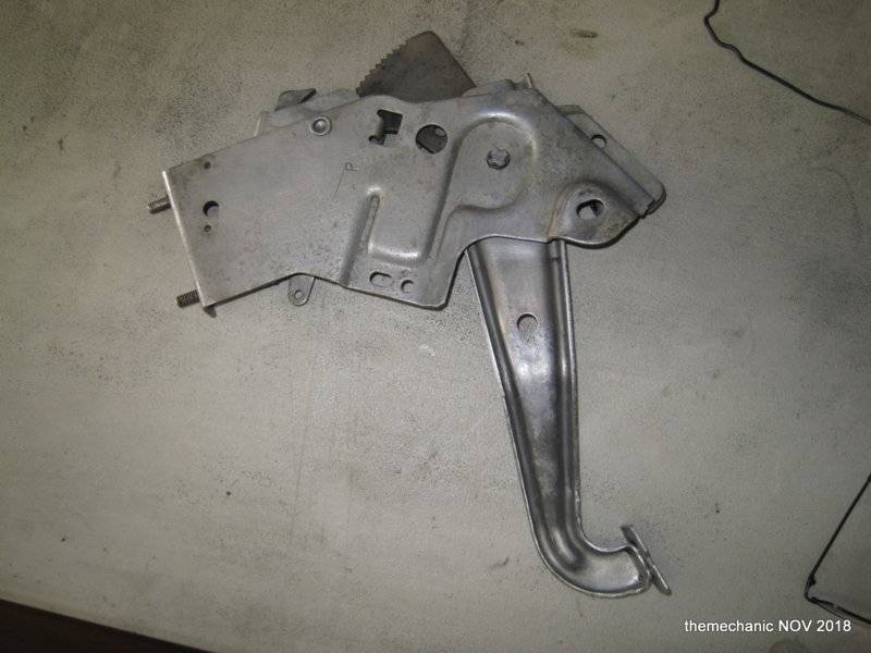

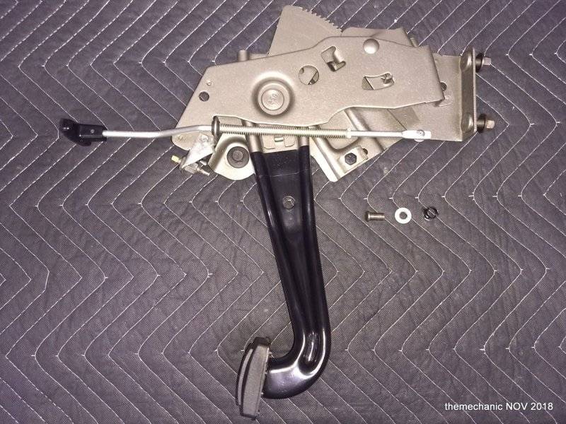

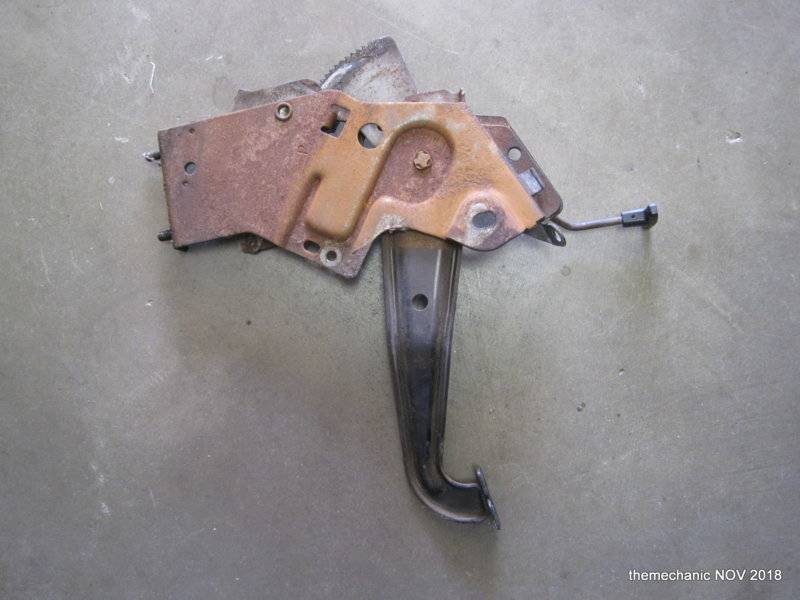

Finally got around to reassembling my parking brake assembly after stripping and painting it. I bought a rebuild kit with new springs and release handle. Didn't turn out too bad. I bought the kit from Mega Parts item# 199-DR056A.
http://www.megapartsusa.com/proddetail.asp?prod=199-DR056A
Coronet parking brake.JPG Coronet parking brake-001.JPG Coronet parking brake-002.JPG Coronet parking brake-003.JPG Coronet parking brake-006.JPG Coronet parking brake-007.JPG Coronet parking brake-008.JPG Coronet parking brake-009.JPG Coronet parking brake-012.JPG Coronet parking brake-013.JPG
Tried adjusting the parking brake but the rear wheels barely turn by hand with the cable loose. I assume this is because the car has sat for a long time and the disc calipers are sticking. Or, I need a manual prop valve. Cass (AKA Dr Diff) said going from 4 wheel power drum to 4 wheel power disc with his kit I could just use the original distribution block.
Put in loctited ring gear bolts and torqued them. set backlash to .004 and preloaded tooth side bearing to get .011 back lash as it was before. Torqued cap bolts and checked gear pattern looked ok.

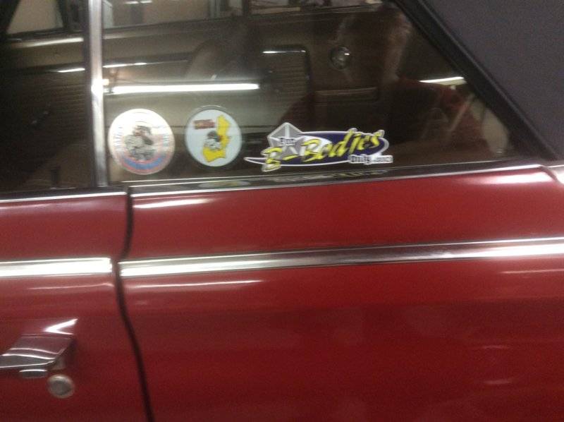

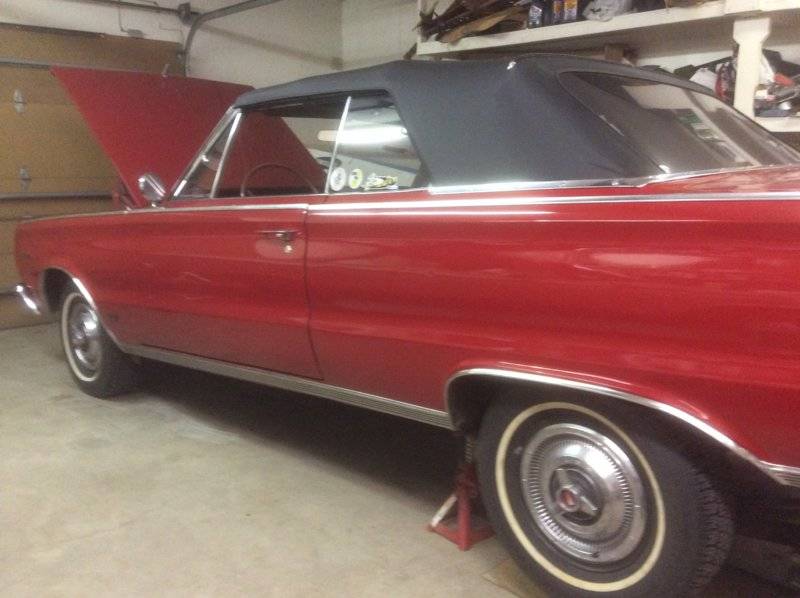

Got the car in the air to change center section. I prefer to pull whole rear than wrestle around under the car. Its been out in the last year put 4.10's in, mistake. About 2 hours I can pull the rear. Think my Chinesium brake drums rub backing plates. Could be 30 years of laying around may have bent backing plates will check that. Will put original drums on but there +.050 now. Put my FBBO decals on.

+1 on FBBO decals. Pull whole diff to put in punkin? Wow, you’re a glutton for punishment,kinda!

Luv the red!!

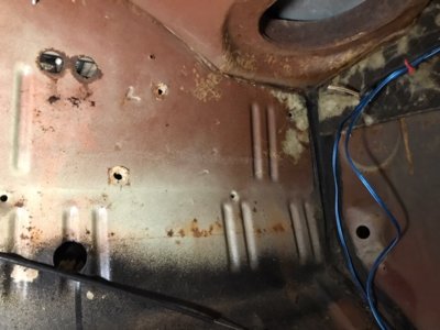

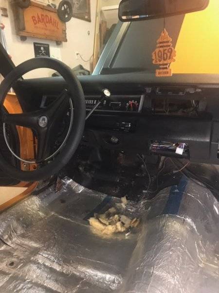

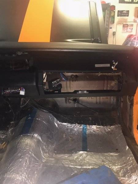

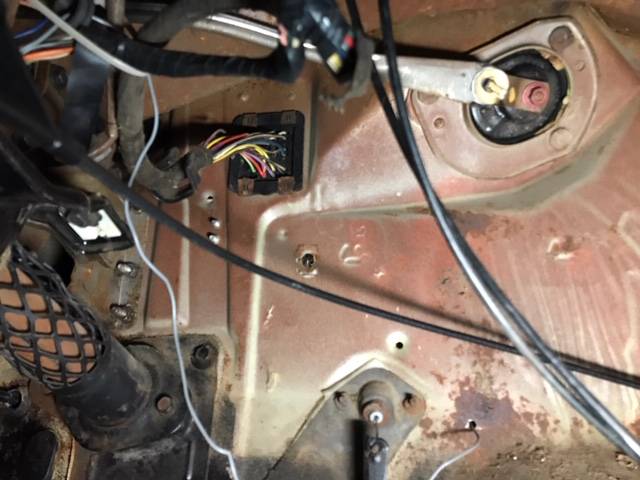

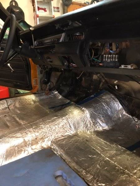

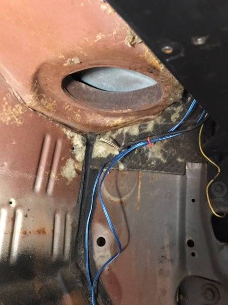

My heater core let loose, so sent it to Bob at Glen Ray. In the mean time decided to redo the insulation on the floor and firewall. One thing lead to another and let's just say it's been a busy weekend.

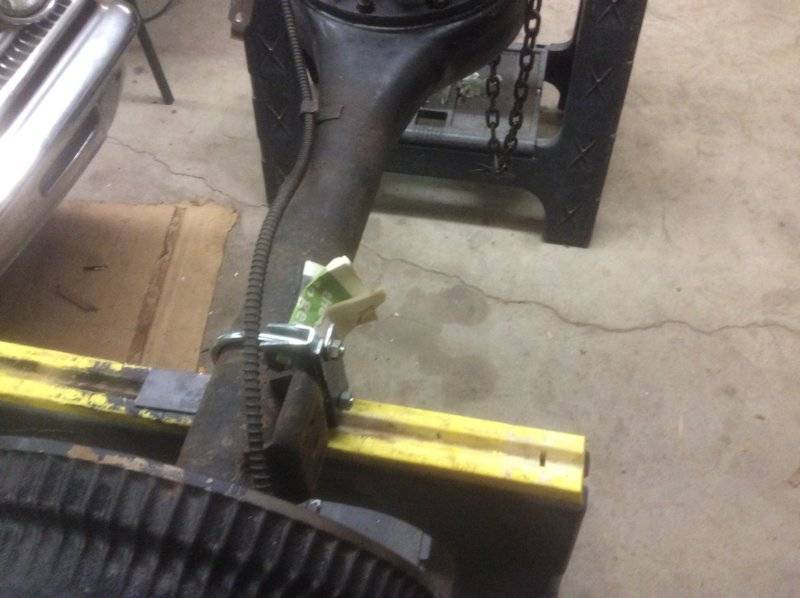

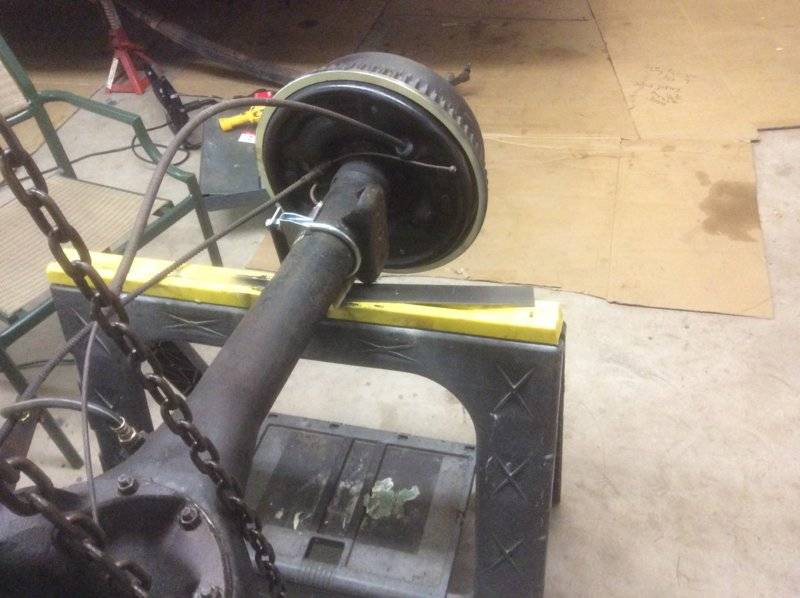

Put rear on sawhorses and made L brackets to keep it nose up. Used 3" muffler clamps to hold L brackets. Only able to bend 3/32" stock, no torch had to stick a block of wood under housing.

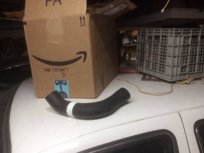

Order a lower hose from Amazon, check the box it came in. It was the only item in it. The narrow side facing camera.

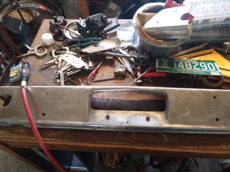

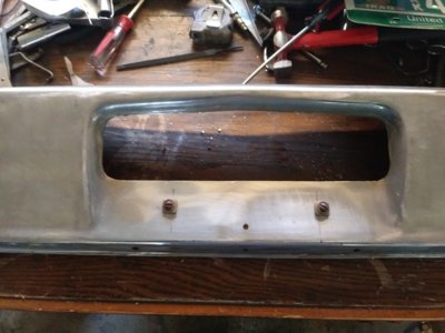

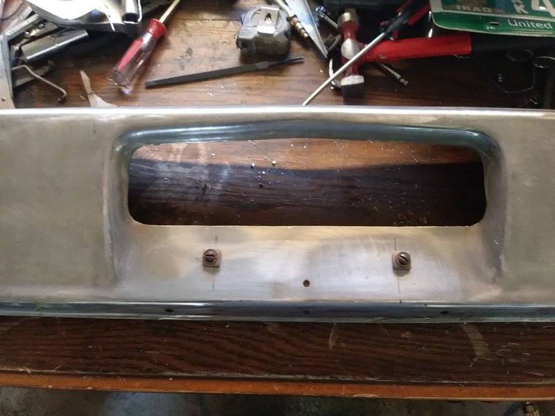

Got the backs of my `cuda bumpers blasted today. Tomorrow, take them to the platers, and see what they do or don't want me to do...before welding bolts in-flush.
