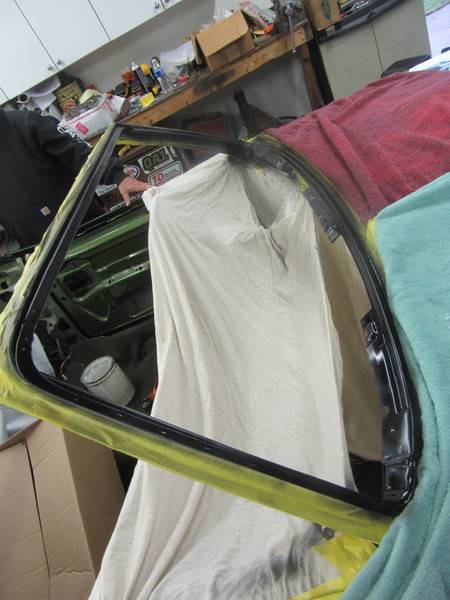

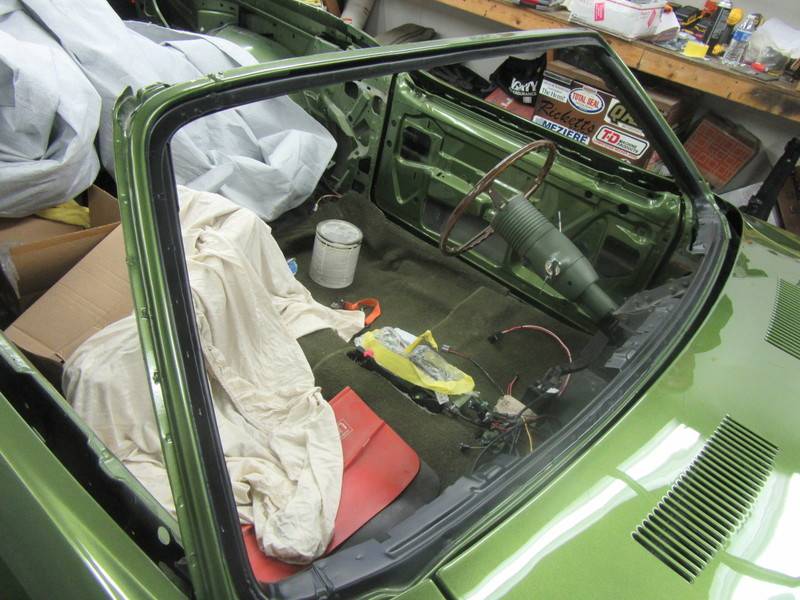

Painted the interior on the windshield frame black. When assembled, body color will show between the moldings. It looks terrible, especially with light or hi-impact colors. Seen verts that were bright....yuck.

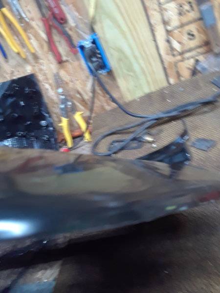

finished the wiring in my radio, cut and fabbed a 3" x7" flat stock panel to hold relay, reversing polarity relay switch and speed adjuster for position adjuster for ashtray all ready to install. need to fab cover plate for control head for hidden stereo system. have 2 prototypes, need to find some thinner stock metal that I can still weld, then paint.:)

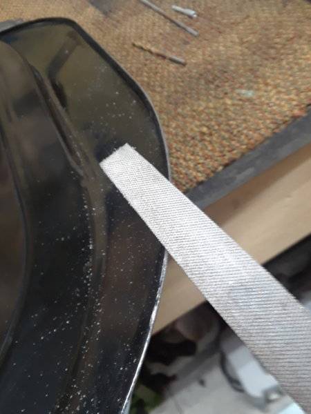

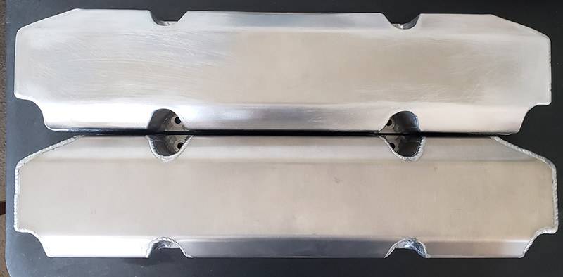

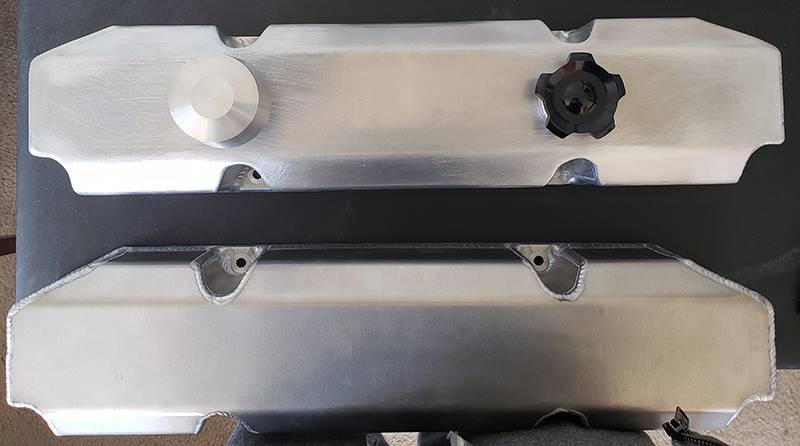

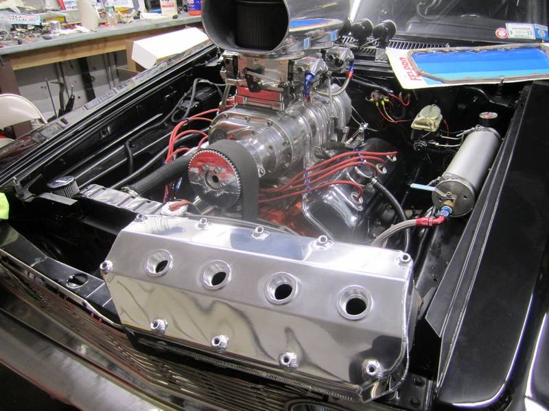

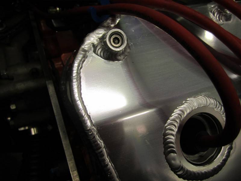

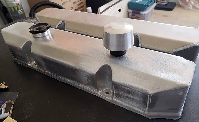

Work continues on new valve covers, smoothing out the welded seams on a pair of aluminum fabricated 440 source covers.
New Earls Performance breather and Vibrant Performance 2" Oil Cap.
Trying to get a nice clean look in the engine compartment, should look good once all parts are powder coated the same semi-gloss / matte black.
Lot's of work, just need to make time and work on it when I have it.
They look great. People on FBBO have mentioned smoothing prefab v covers can cause pin holes. I'd swish a little gas inside just incase, gas will find any pin hole.
Yes, I've heard the same which is why this is all hand done and taking a while. Weld seams on the inside are nice & thick too.
I'll definitely check everything thoroughly before strapping them on. :thumbsup:

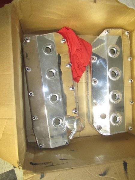

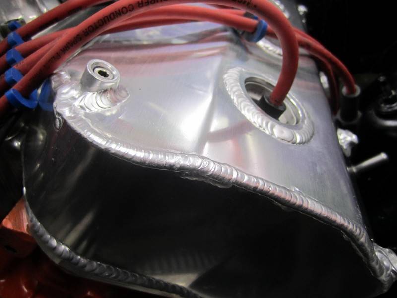

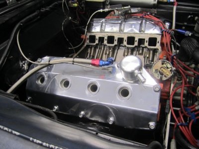

I like the pretty beads! Not bad for a poor china man working for 10 Yen a day:lol:

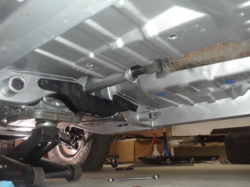

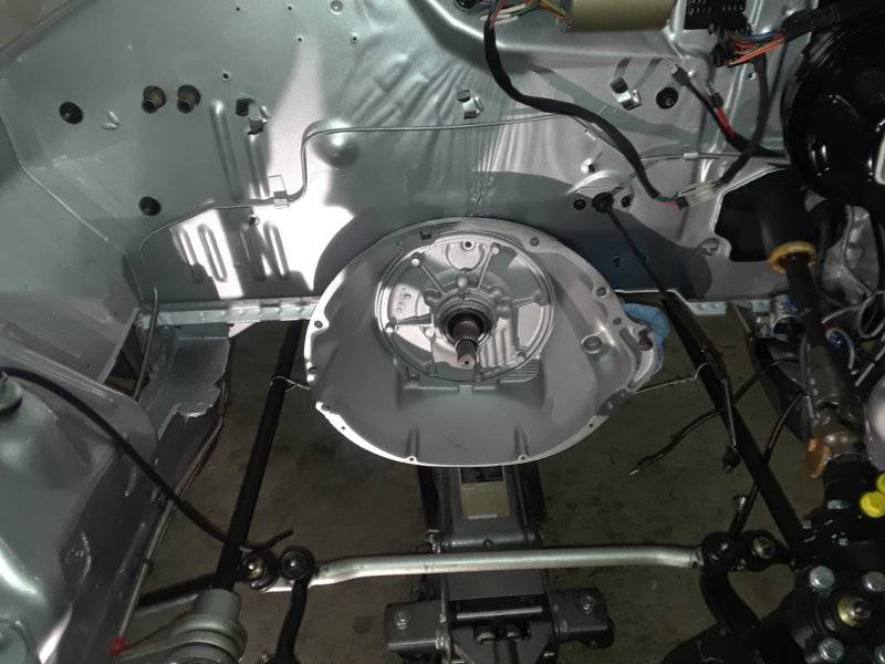

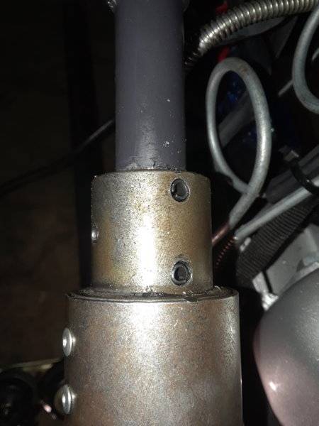

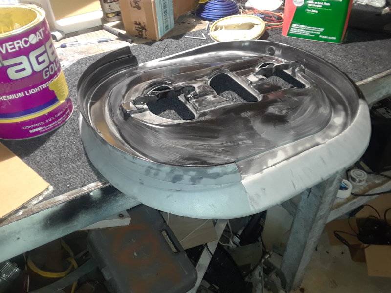

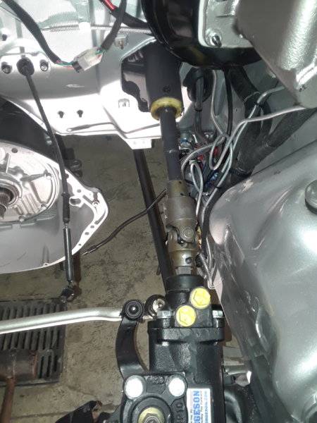

got steering column pinned, to new coupling for the borgeson power steering, adjusted alignment half assed with a laser squaring off the rear tires kind of like the string and two cement block trick set steering wheel to center, we'll see how close I am when is all over. got transmission in, lubbed up the yoke and slip it in her to see if I'm still there.

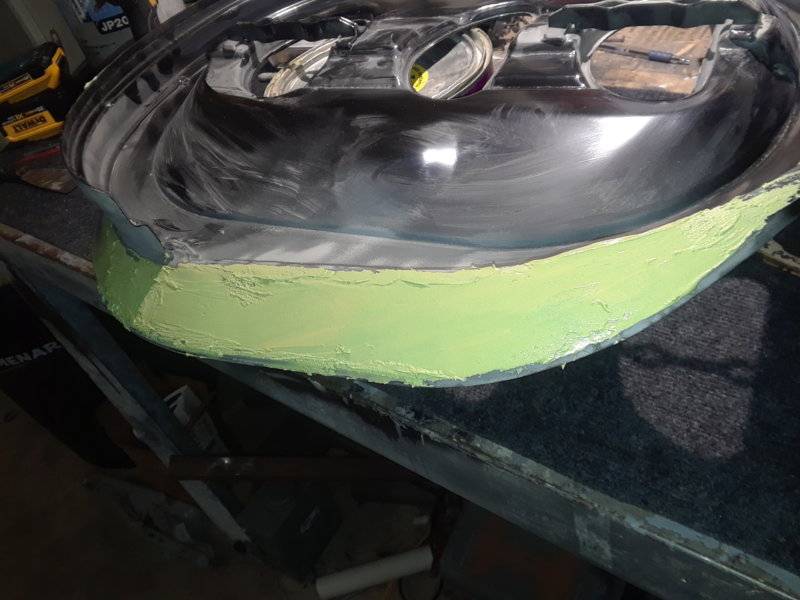

been 4 years since that baby has been in there. also beat on the new six pack air cleaner to straighten up some manufacturing dents and got a coat of bondo on it looks lot straighter already. now take the drive shaft back out and clean it up and balance, probable replace yoke looks pretty worn in center.

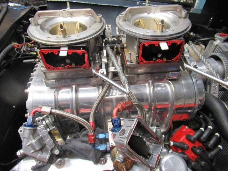

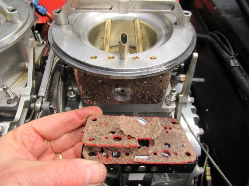

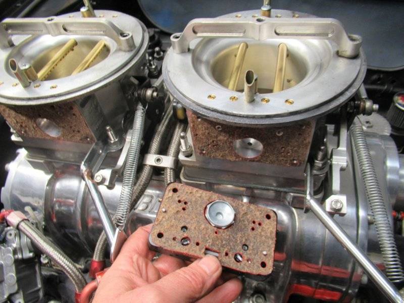

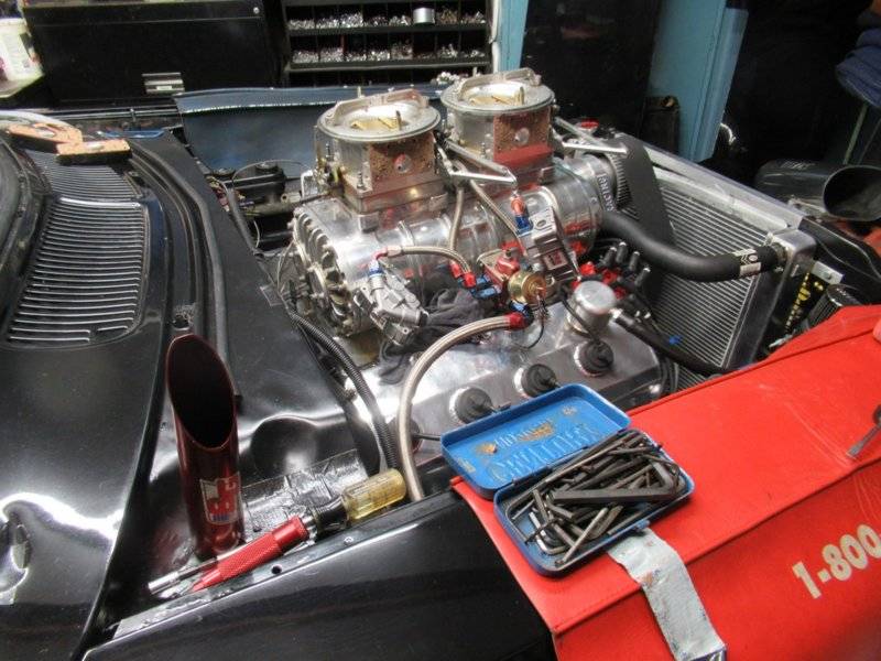

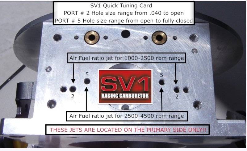

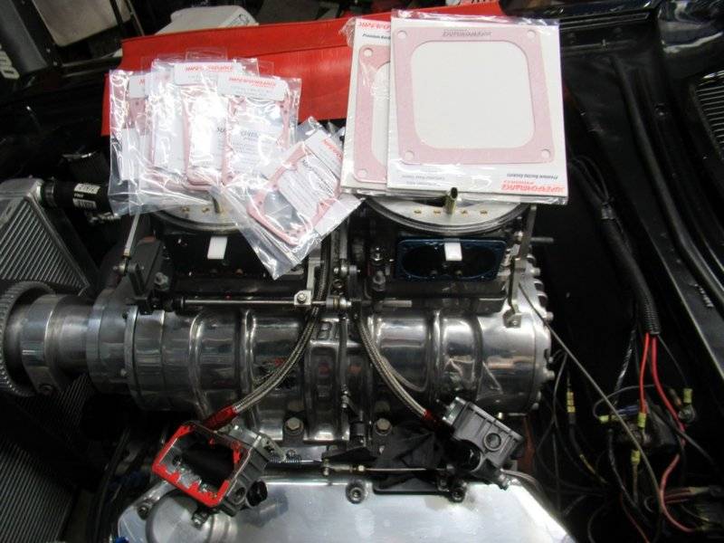

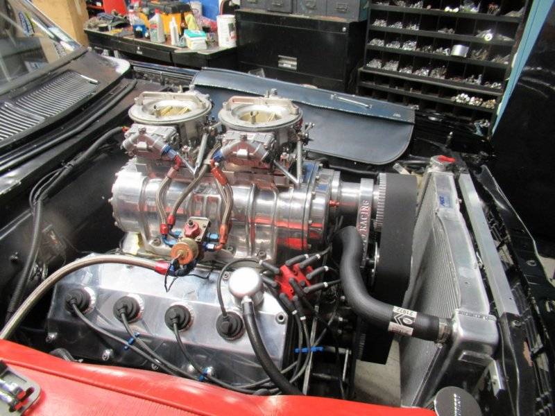

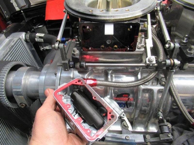

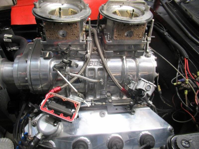

Took the carbs off to enlarge a tuning port. Good thing I had no stick gaskets:screwy:
Ordered in all SUPERPERMORMANCE gaskets.They do not wick in the gas or oil like the blue gaskets!Just lube them up a little when reassembling:thumbsup:
Next trip to the garage will slap them back together and do some test driving:lol:
