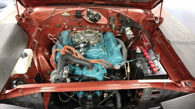

All together and going back in today...

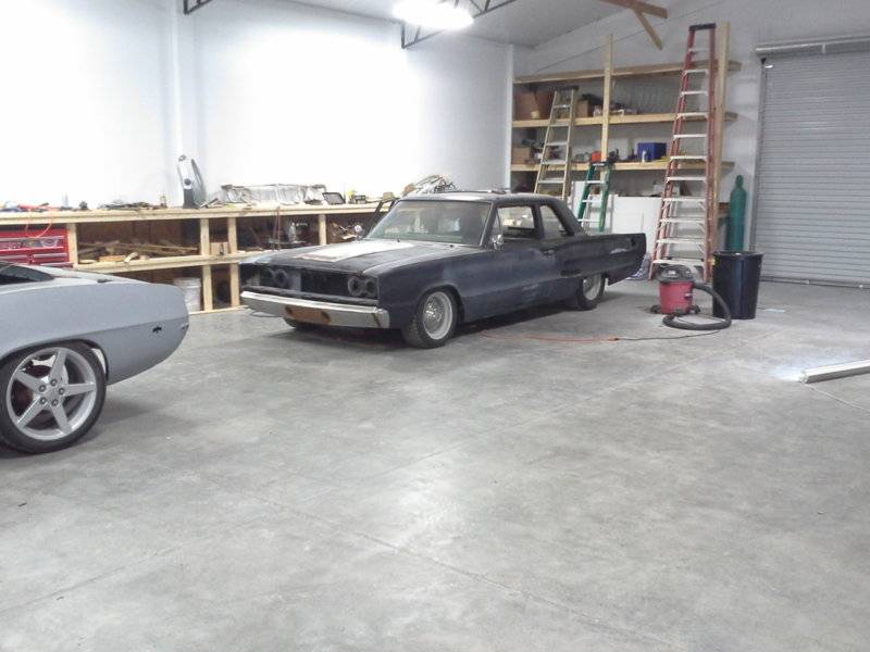

Moving my 72 from one 12x20 bay into the one next to it so I can rent out another one and hopefully make some more "car money" every month.
The last one was the break even unit. This one will be all profit, a whopping $61.50 after federal taxes.....and I split that with my wife.

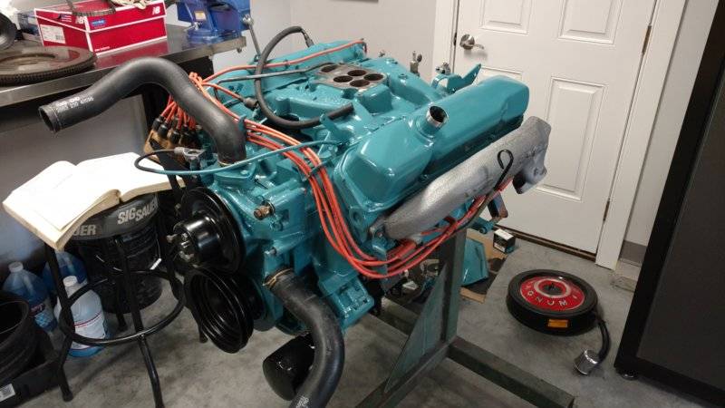

I installed the carbs, pre lubed the engine, set the timing by hand for 12* advance, turned the key and it fired up and idled. First time I heard this engine run...and it sounds good!!!
Back in. All that's left is the radiator, heater hoses, fan & coolant. I've done enough for today and am bushed. I'm getting too old for this kind of work.

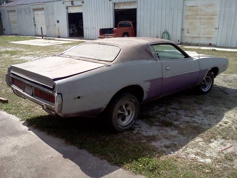

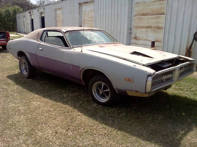

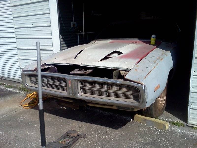

This is the one I recently learned is 1 of 503.
Needs both quarters, roof, dutchman, and some driver side cowl work.
Unibody is surprisingly solid as is the floor and trunk floor.
I am waffling very hard on what to do with this car.
I bought it with the intent to restore, but then found-
The roof issue and one quarter already replaced somewhat poorly.
Plan B was to keep the 8 3/4 SG axle and part out the rest.

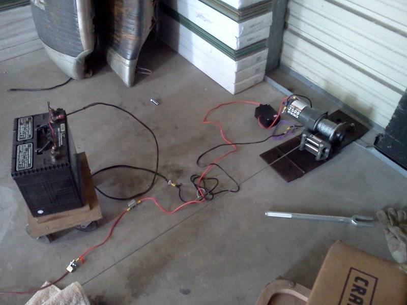

For $50, that HF winch has been money well spent, despite the remote crapping out the third time I used it. I'll make a hard switch when I get time.
Those are railroad tie plates holding it to the lag bolt and keeping it level, and...
That's a tie rod fork keeping the cable wound evenly.

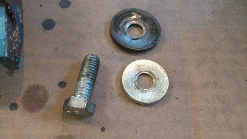

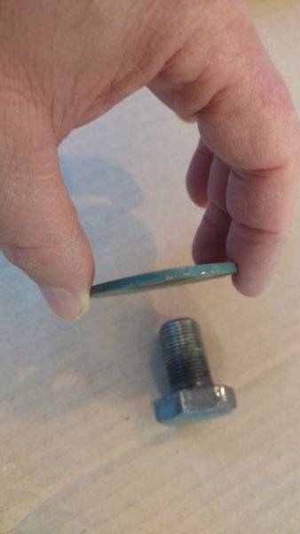

My 68 4-speed Charger that I bought 2 summers ago ran pretty well, or so I thought. The engine had been rebuilt and balanced several years earlier by the previous owner, but after I replaced the 3" exhaust and very loud Blowmaster mufflers with a stock system, I found that there was an engine vibration. So, I took the engine out and apart a few weeks ago and the first thing I saw after the intake was off was that several of the intake valves had oil crust build-up. When the timing cover came off, there was a standard chain and gear set in there plus a hardware store bolt and extra washer holding the cam sprocket on. The big washer on underneath the crank bolt was also a thin hardware store item. The rear main seal cap had a weird die grind in it and two freeze plugs had indications that they were weeping. Fortunately, upon full disassembly, I could see that the cylinders walls and crank journals were good. Keep in mind that this engine was rebuilt "professionally" by the previous owner's shop of choice out in Colorado.

The rotating assembly came back from the balance shop yesterday and the guy at the balance shop told me that the weight of the rods and pistons were actually balanced pretty good, but the previous balance shop flubbed up with the crank. He said that when his bob weights were on and they spun it, it was showing that they had to remove metal to outside some of the counterweights. He also said that on the rear of the crankshaft, it showed that metal needed to be added to the left of one of the rod journals where there was nothing, so they took metal from the counterweight opposite that point instead. Most likely, the previous balance shop made up the difference in removing weight from the flywheel with it bolted on, which now explains why the flywheel had so many drill holes in it around the perimeter of it. My guys balanced the crank with the bob weights, and then the balancer, flywheel and pressure plate balanced separately. After that, they bolted it all together and fine tuned it. He did tell me that he could tell that the amount of bob weight that the other guys put on had to have been off a little bit, but how much, I do not know. From other jobs I had done with them years ago, I remember that these guys are very fussy about their work.
