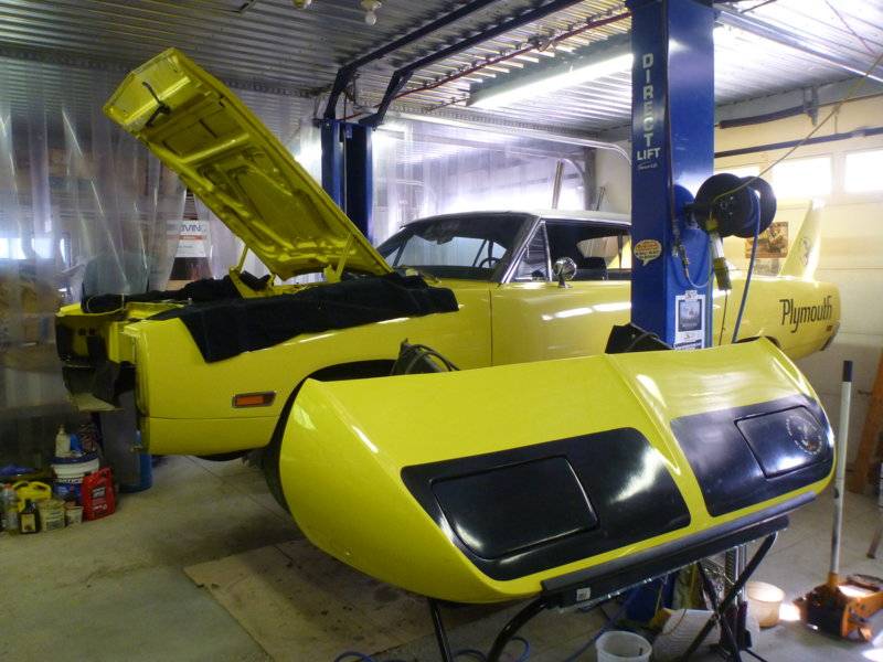

I watched my body man prep the Satty for paint. No wonder Graveyard cars and others use so much skim coat.. Couldn't believe how many little dents -ripples there are. I don't think it will get paint before Saturday--just as well because he won't do a hap- hazzard job... Got home to see the new complete " Vintage air" system arrived. ..................MO

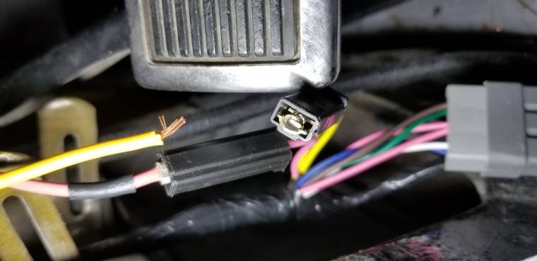

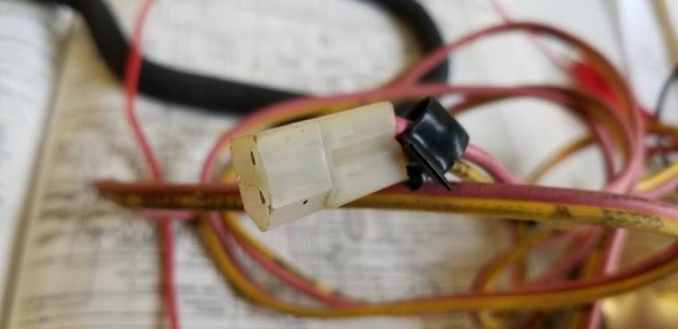

I continued tracing the dash and body wiring. Today, I found a bit of mess where the modular plug for the dome lamp should have been. So, here are photos of what I found and what the modular plug should look like. I was going to cut out the factory modular plug from extra wiring I have in the garage and splice it in. Instead of creating four splices, I'm going to use a Weatherpack terminal.

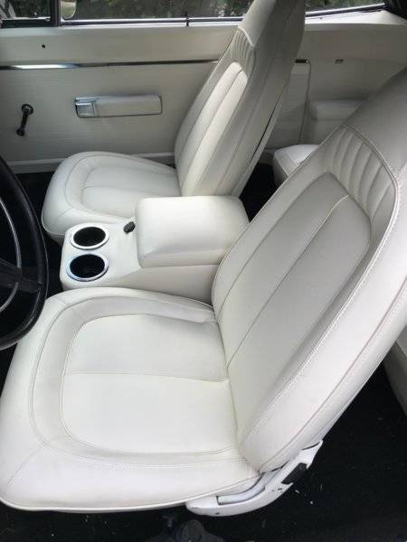

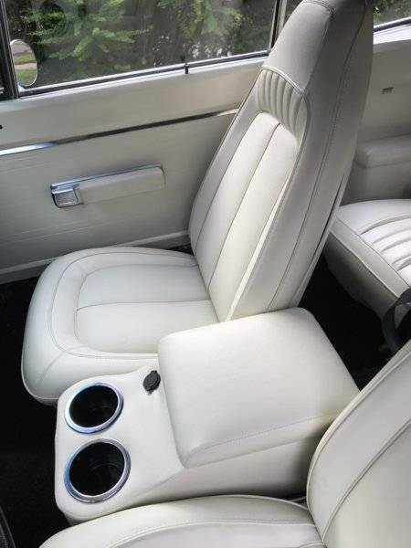

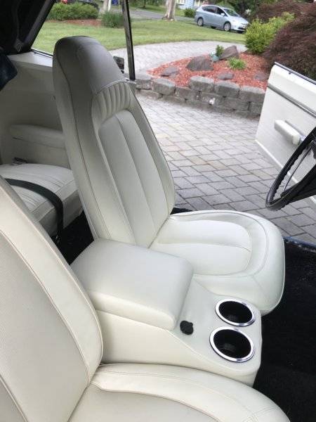

LOL. OK. I put the tracks in backwards, narrow part towards the front. So two things are wrong. They're pitched forward and they don't move back all the way. I'm not a tall guy but only a little person could drive it as is. Easy fix though.
Took the buckets out and swapped the tracks, work perfectly now. Also installed a humphugger center console/armrest. Color matches the seats perfectly and it fits right in between the two buckets tight without even using any velcro. I think it looks great !!!!! Took the car for a cruise around town too!! :lol:
Beautiful interior! I also have white much like yours from the factory, white door panels/armrests and the upper part near the glass with black carpet. Seeing yours done gives me some motivation to get mine there eventually. Center console looks good there too.

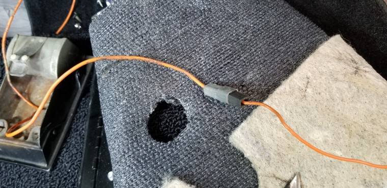

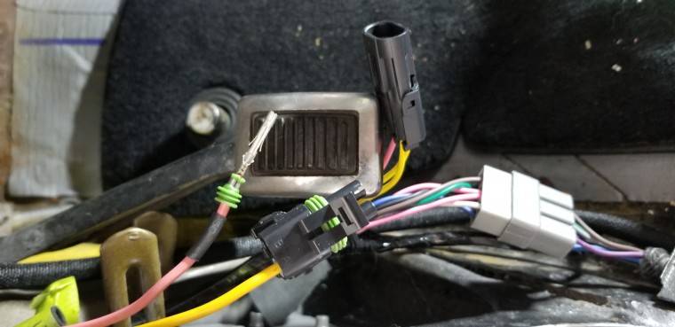

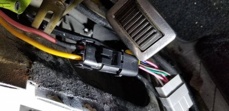

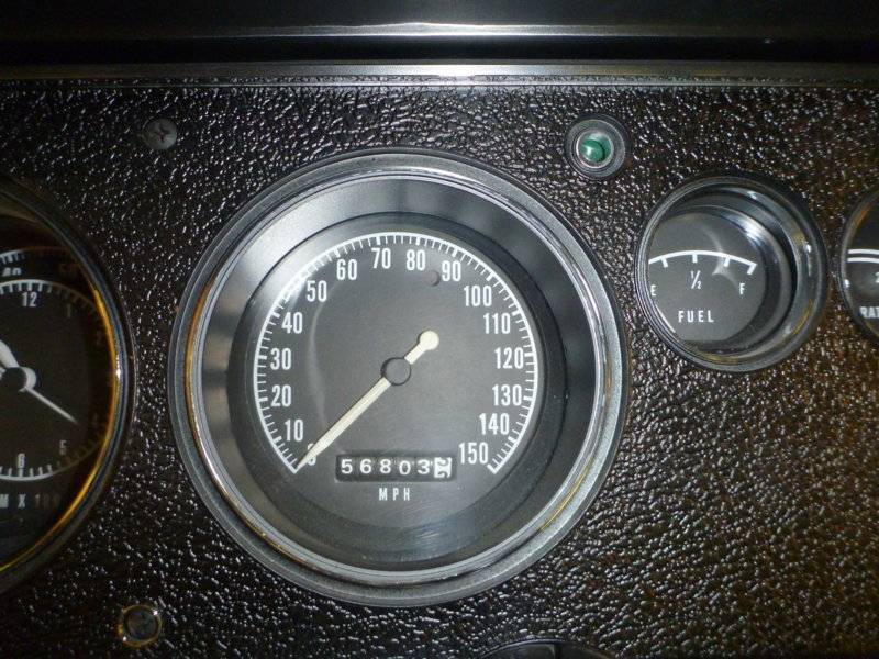

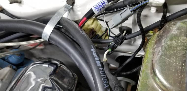

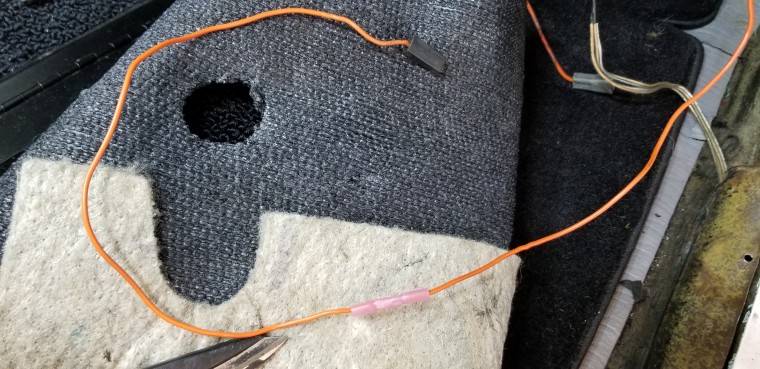

Today, with the iffy weather, I skipped taking the '55 Plymouth to the Mason Dixon Mopar show and stayed home and continued to work on the Charger's wiring. I put a weatherpack terminal into the dome light circuit to replace the missing factory modular plug. No idea why that was missing. I also cut the tach wire and put a weatherpack terminal on that inside the engine compartment. I even finally figured out where the console shift indicator light should have been connected. I found in the factory wiring diagrams, hidden at the back of the accessory wiring diagrams, an illustration showing that I should have had a long orange wire running to the right kick panel. That explained the super-long wire my "hot rod shop" had hooked to the back of my tach. Since my tach was from Charger Specialties and not from the factory, I finally realized it was odd that the wire providing 12v to it had a factory part number. That's when I realized it was my missing wire for the console shift indicator light. So, I dug out an old dash harness from the garage attic and cut off the ash tray lamp wire and spliced that onto the end of the wire that had been feeding the tach to replace the factory plug that had been cut off.
