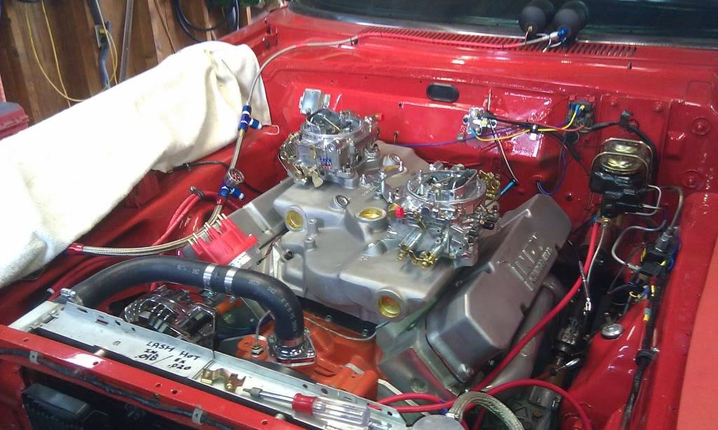

installed the 40 micron f/filter close to the f/tank and test fitted the 80 micron after the pump. snugged up the 1/2" f/line and emergency brake lines to the rear disc brakes. set the hemi in place for fit and clearance check. it's real close to the r/front shock tower housing. hope the tti's are as good as they claim. when i ordered them for a 69 b-body using shumacher kit they said ok. looks real close. tomorrow is another day.
the pass side went on slick. lift the elephant about 1" on in they went. drive side will be interesting with steering box. oh well, if it was easy anybody could do it.
