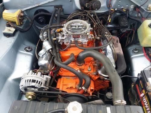

Wow....just noticed some before and after engine pics...

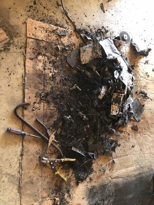

Started cleaning the Underside of the floorboard on the passenger side. Lotta old undercoating slopped in the front torque box.

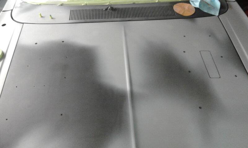

Didnt need to but took me a year to swap the hood numbers out also swapped the front susp and re-adjusted the hight.

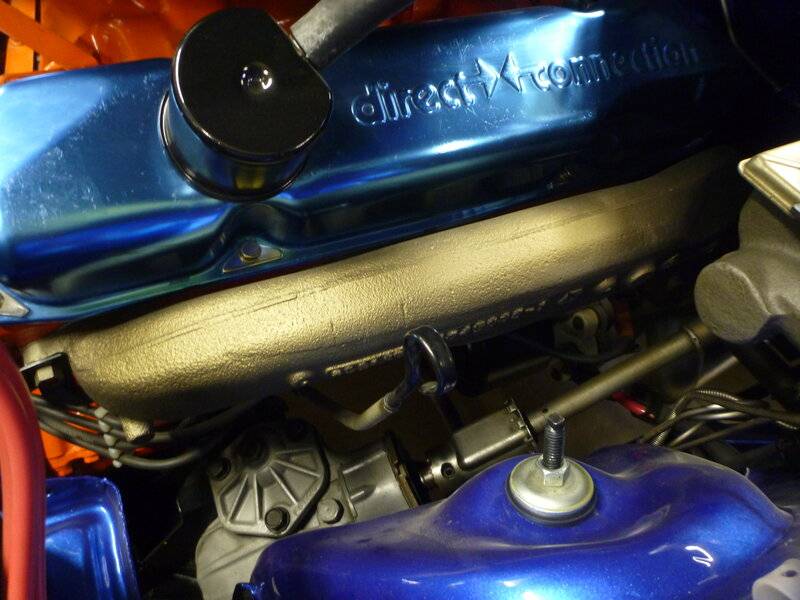

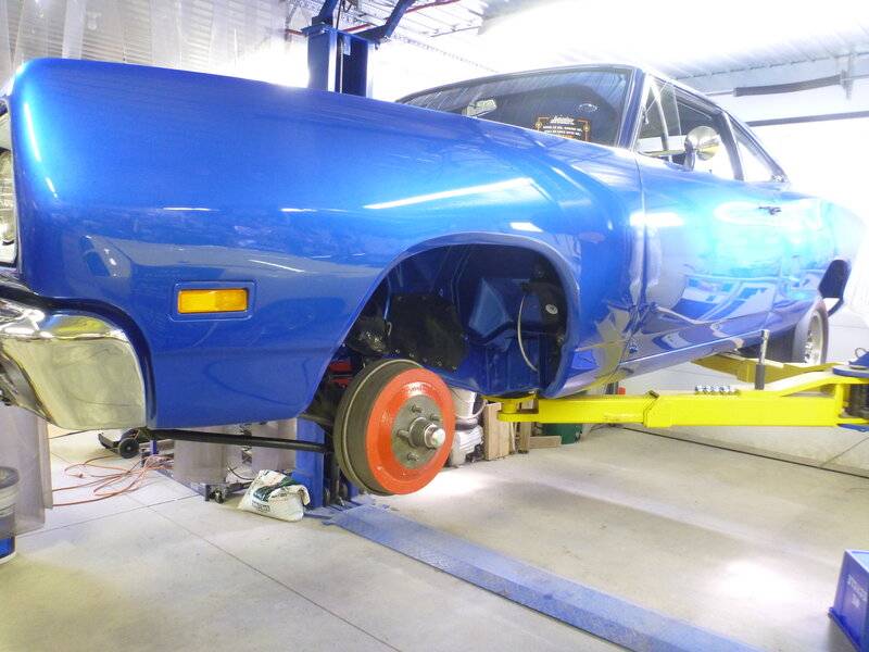

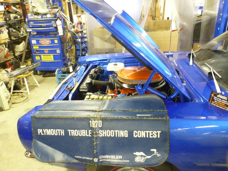

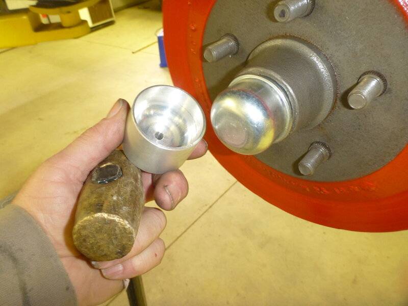

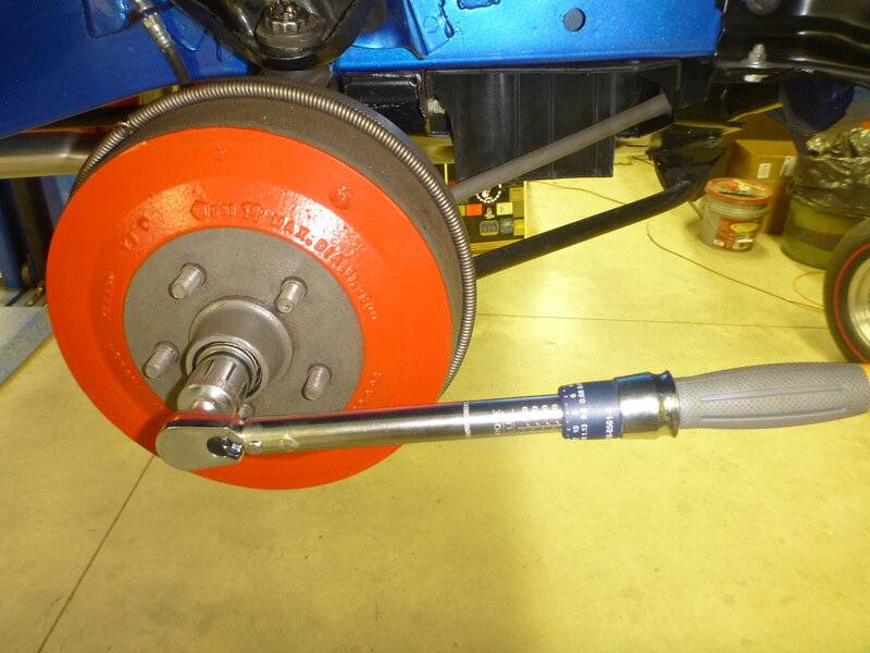

Checked my front outer wheel bearings conditions (fine) and retorqued both spindle nuts at 90in-lbs. Was a lot easier back when we used a hammer to removed dust caps. :eek: Tire wear looking good on my Goodyear Redline Raceways. Snugged up my weeping rocker covers and :praying: that stops the drivers side from leaking and noted after 204 fairly hard miles, power shifting all the way, there is yet to be any discoloration or burning off of the VHT Cast high heat paint I baked onto my HP manifolds. Ready for another cruise... :steering:

I use a rubber hammer to remove the dust caps and a PVC plumbing cap to tap them back into place.
