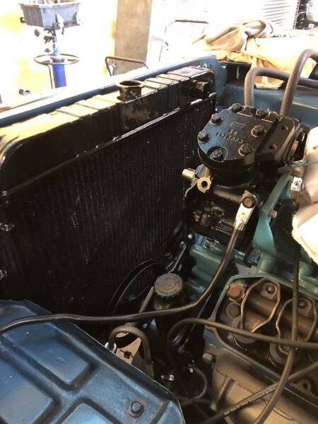

Got my shocks installed today plus my radiator.

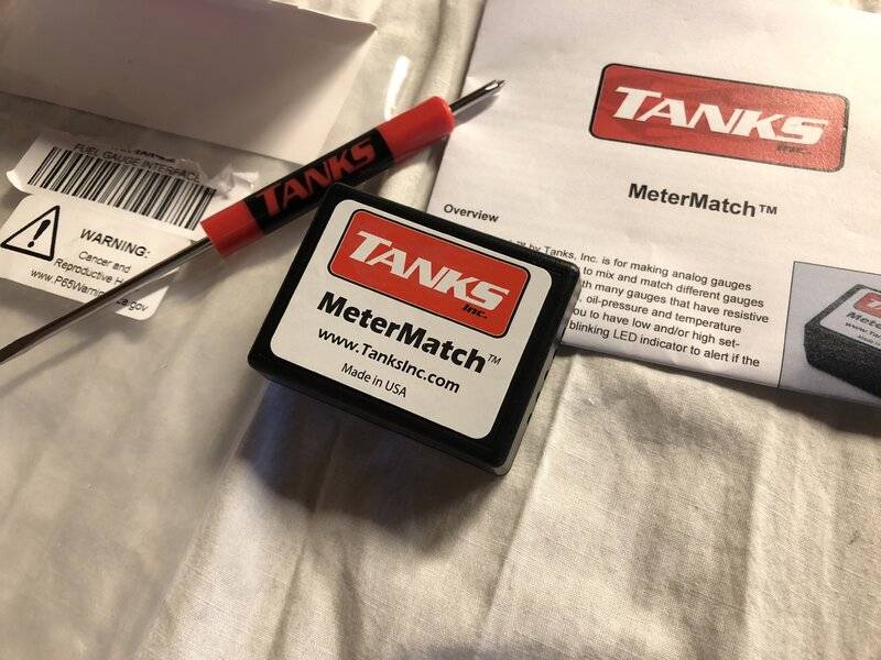

installed a Tanksinc Metermatch box between my fuel sender n gas gauge...did the calibration and went for a drive...added gas...level matches up with amount of gas finally.....hit 500 miles on the new SST TKO500...break in period over...time for a fluid replacement

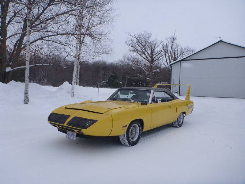

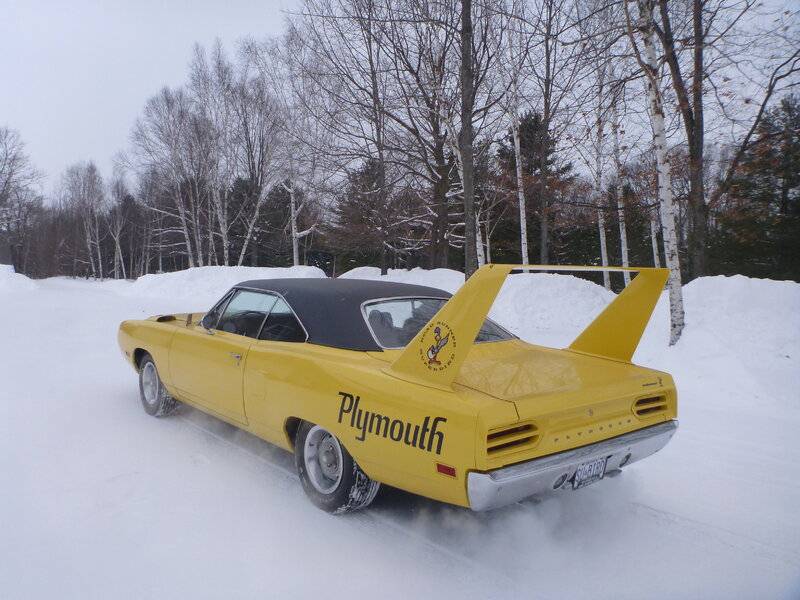

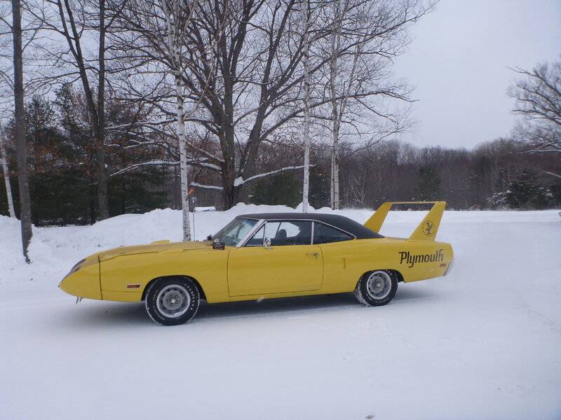

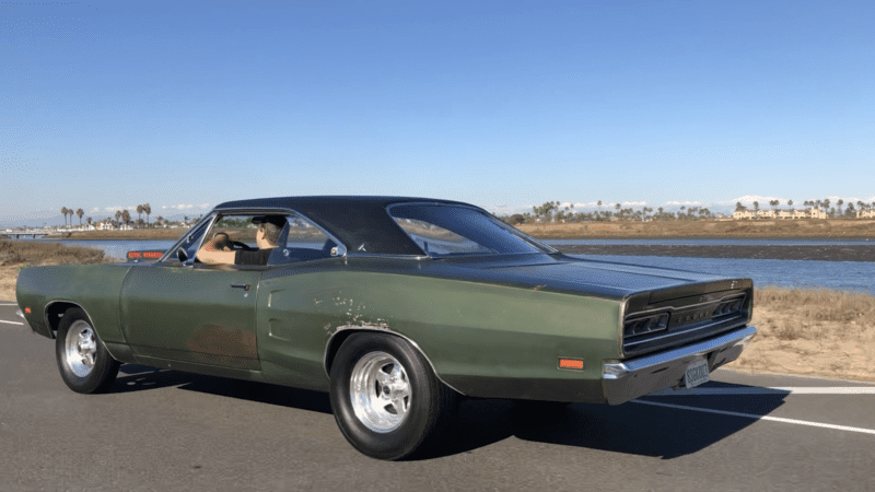

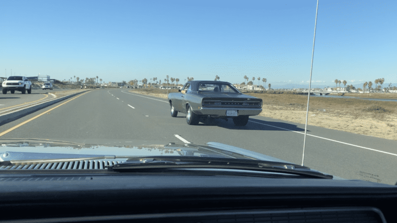

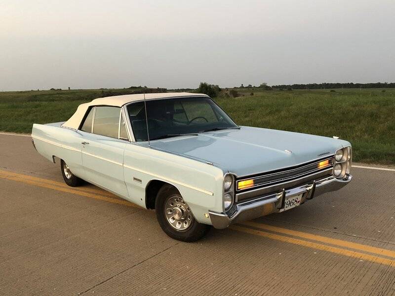

saw a pretty sweet race car out on road too
watermelon

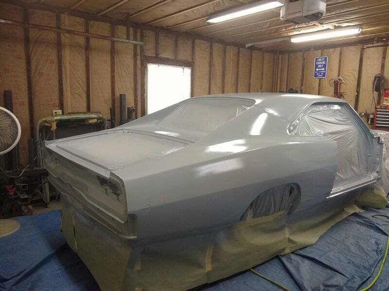

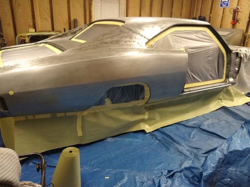

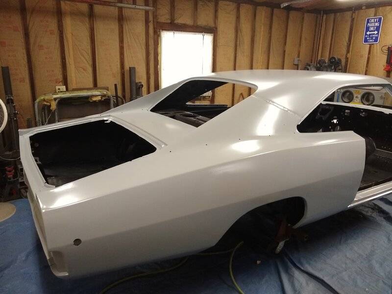

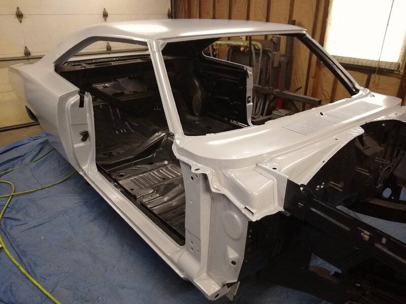

Got the body epoxy primed this morning after prepping it this past week. Now the primed body panels can go back on and I can start the body work!

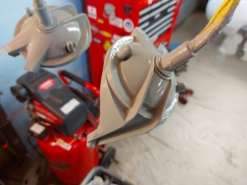

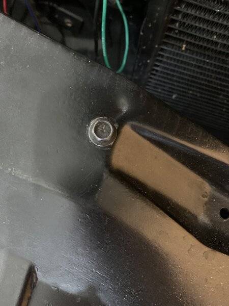

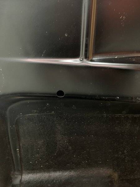

My Charger has a fibreglass hood. The bolt that holds the inner side of the right headlight assembly was missing because it wouldn’t let the hood down low enough to get the hood pin in. I drilled a hole to allow for the bolt head and touched a little paint on it to make it looked finished. I did both sides so it looks like they’re supposed to be there.
