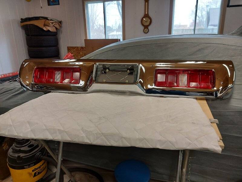

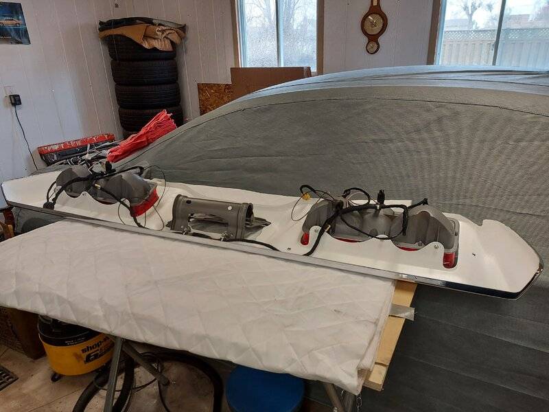

Shined up this gal today

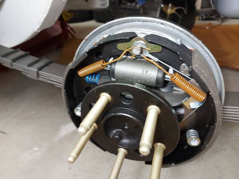

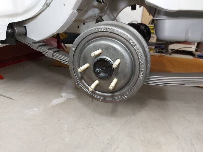

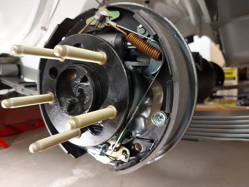

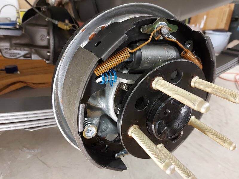

All I could get was Centric brand. Not sure what to think of them, I've never used this brand before. I did not put them on yet, got sidetracked helping a buddy. Hope to install and test drive this afternoon.
Come to find out, there's more than a few companies out there making the shoes - including Bendix,
which I believe are the OEMs on the originals.
My choice has been narrowed down to either the ones sold by musclecarbrakes.com or the ones Professor Ehrenberg
is selling - which I suspect is also Bendix.

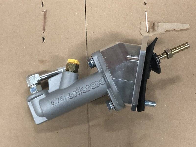

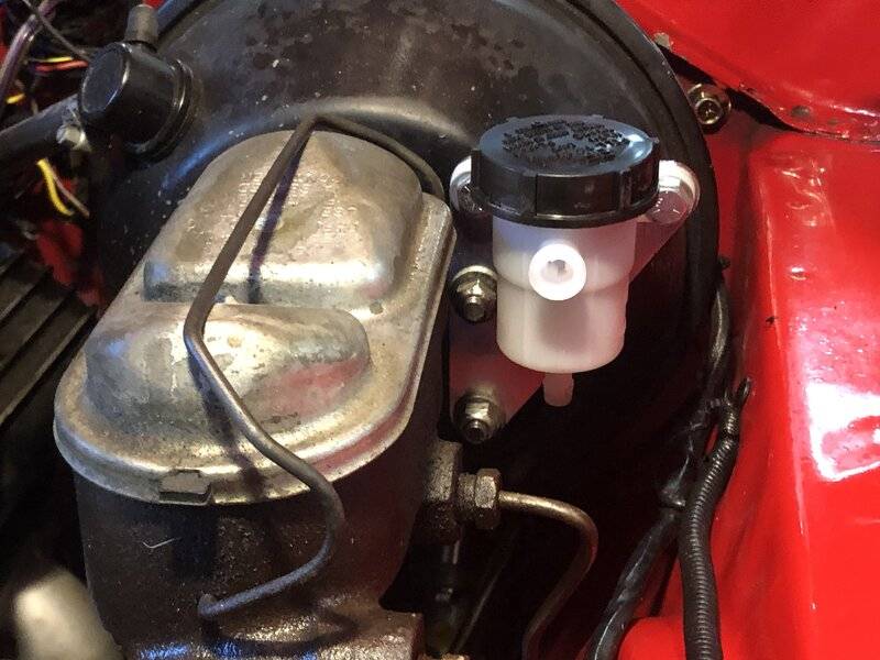

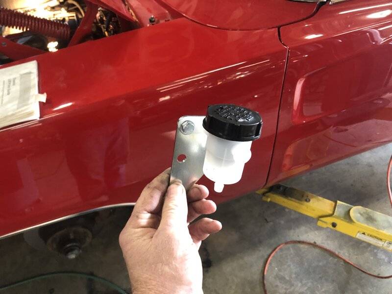

I know you like the factory correct stuff but the hydraulic clutch setup in my car is GREAT !

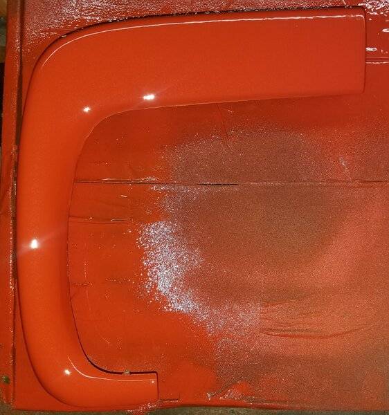

Dying to locate a LH and or RH 69 Coronet Quarter Panel Extension. (A12 Soup Bee).
These seem to bee thee hardest thing to locate. Made of "Pot Metal", the studs snap off if overtightened. I have one, but it's shiit-shape. (I need to re-learn Auto painting.
I get an exact match "PPG Deltron 2000" but when I clear coat it, it tends to look more pinkish? WtF?

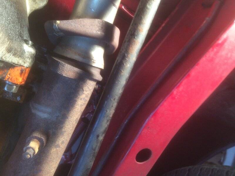

Crawled under Satellite to find passengers side exhaust leak. Found it and get out the Rube Goldberg *** kicking machine. Knew the flares were cockeyed, looked like they'd work, Not! If you look at flare there is a rusty line from flanges. The flares bottoms out on manifold before seals. Going cut parallel to rusty line where tube sticks out excessively. Then hope it works.
