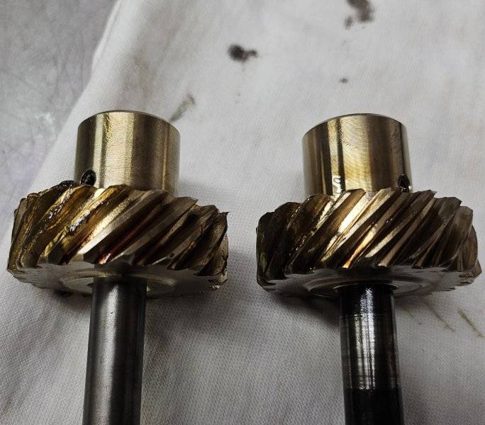

Checked my intermediate shaft (I run a roller cam in my 500 CI stroker based on a 400 block).
Left is new (but has assembly lube on it) and right was in my car. It might be hard to see in the picture, but it's time to replace it.
Just curious.. how long did it last? I have never run one til this motor and worry bout it..

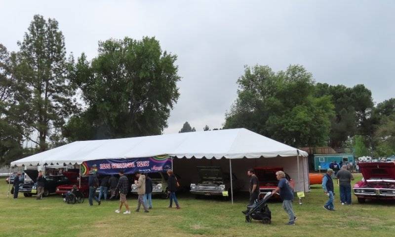

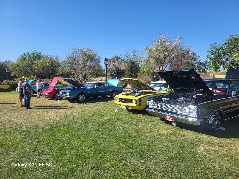

Spent the day yesterday at something new to me
I was approached a few months back requesting I enter my car at this event .
After some discussion with my wife , we decided to give it a shot
2025 Western Spring Nationals/Grand National – Tucson, AZ – AACA – Antique Automobile Club of America
I decided to enter a local event for the AACA club aaca.org
Its close enough I could sleep in my own bed.
And was something I decided to do to see how my car was viewed by an actual judging staff / team
After talking to the judging team captain, he said the only real deductions were the radial tires ( I will send in to get a copy or the scoring sheet in the next few weeks )
We came home with a Junior 1st . And I was quite suprised / elated to say the least
I told said team captain, I had virtually little to no interest in going after something higher / more

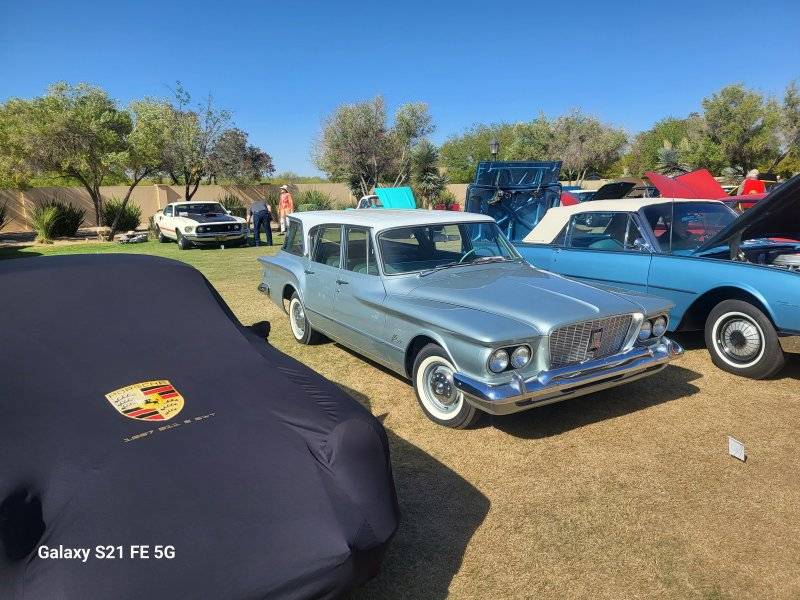

Ps, there was a really, REALLY nice / very cool little Valiant wagon there.
Awesome day!!!

I originally built the engine in 2009, and I sold the car in 2019, so I ran it for 10 years. I had replaced the bronze gear once. The car did not see a lot of long trips (mostly 1/4 mile at a time), so I probably only put on 1000 or 2000 miles per year. Likely I changed the gear closer to when I sold the car.
Thanks QK, makes me feel better :)
I just checked my pictures and apparently I changed to the Edelbrock heads in 2014, so likely I swapped the bronze gear when I had it apart, which would have been 5 years of limited mileage.

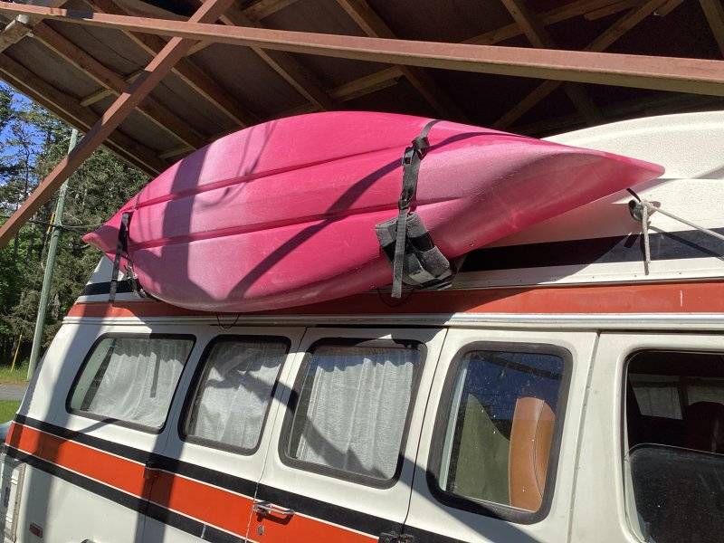

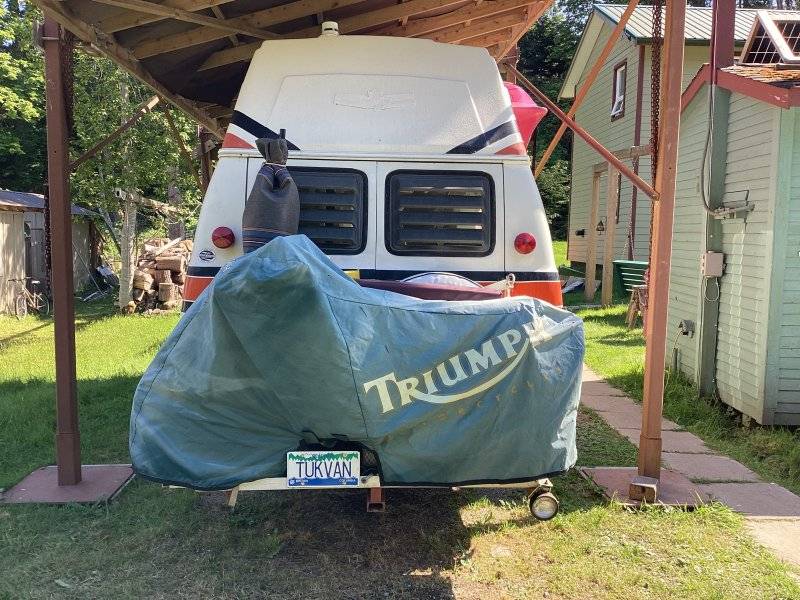

Getting the TUKVAN ready for our next trip. List is getting shorter. Kayak is on the side, bike is on the back. We leave for distant places in about two weeks

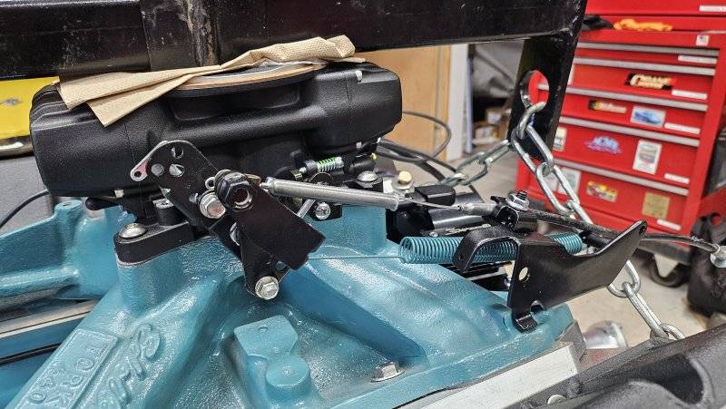

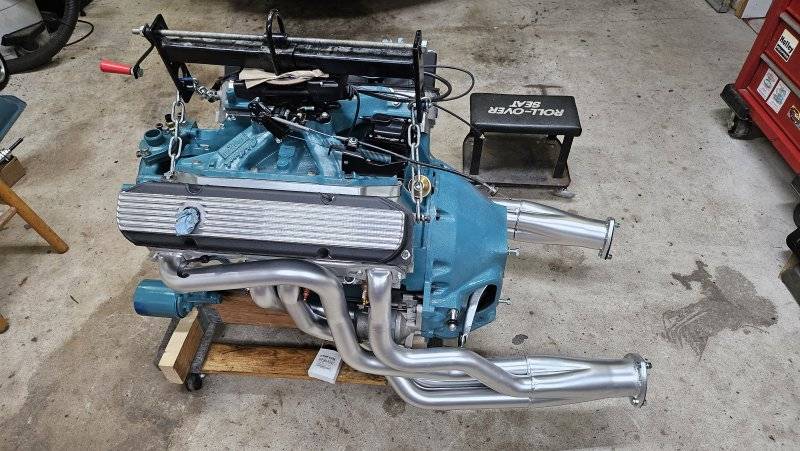

Working on my buddy Barry's engine.
We got the flywheel, clutch, bellhousing and starter on. Runout is .004", which is acceptable.
We also cut, welded and painted a throttle bracket so the throttle cable is properly in-line with a straight pull.

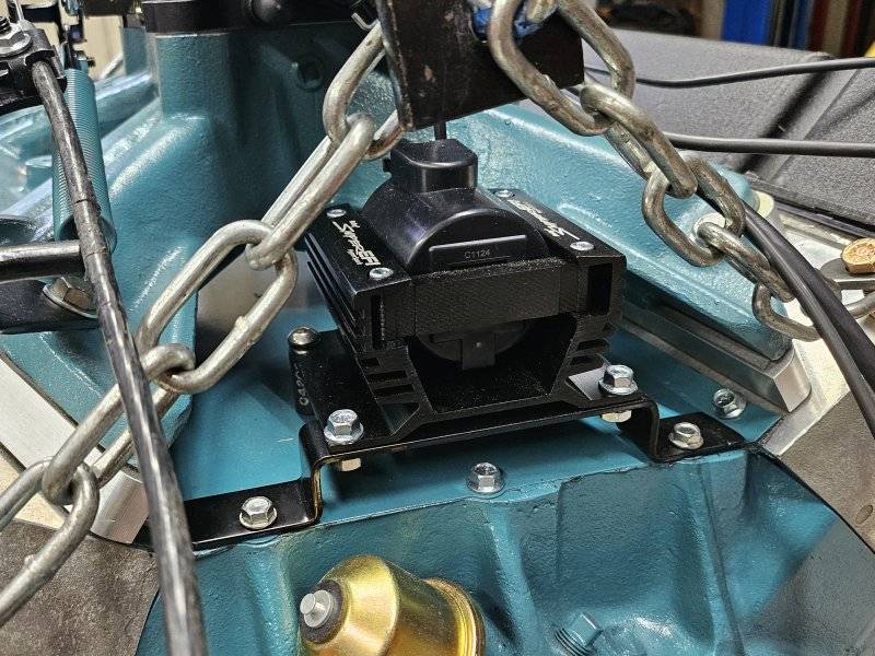

This car will run a sniper system, and it has a big, bulky coil. We mulled over replacing the coil, but elected instead to make a custom bracket that holds it behind the intake manifold. So far, so good. If we don't like it, we can merely unbolt it and replace the coil with a standard one in the front.

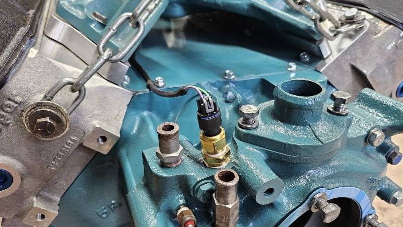

We are also messing with little stuff like cable routing. The sniper needs to know temperature, so we ran the cable from the throttle body under the manifold. We clipped it into place so it won't move. It will just have enough room to sneak around the distributor once that is in.
They do look familiar. Also kind of reminds me of the coil relocation I did after removing the webbing on the Street Dominator. Are you concerned about hood clearance at all with the manifold spacers?
Short answer: Yes.
The car/ hood has been modified and we will ultimately make the hood scoops into a functional air grabber system. But the interface between the engine and air box has not yet been fully designed (and only a prototype air box has been built). I believe it is likely we will need a drop base air cleaner base, but we just don't know actual clearance yet to start designing and building that.
