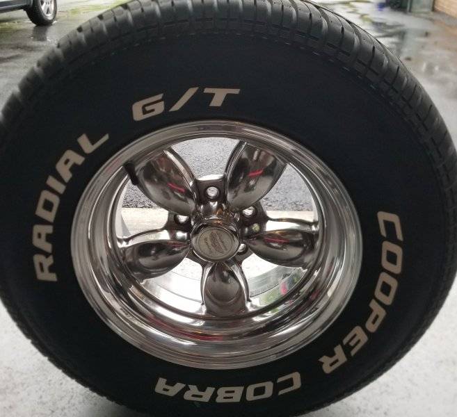

I started the annual PITA of polishing the wheels.

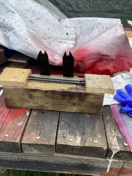

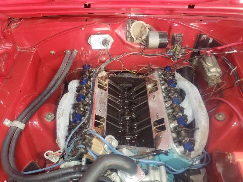

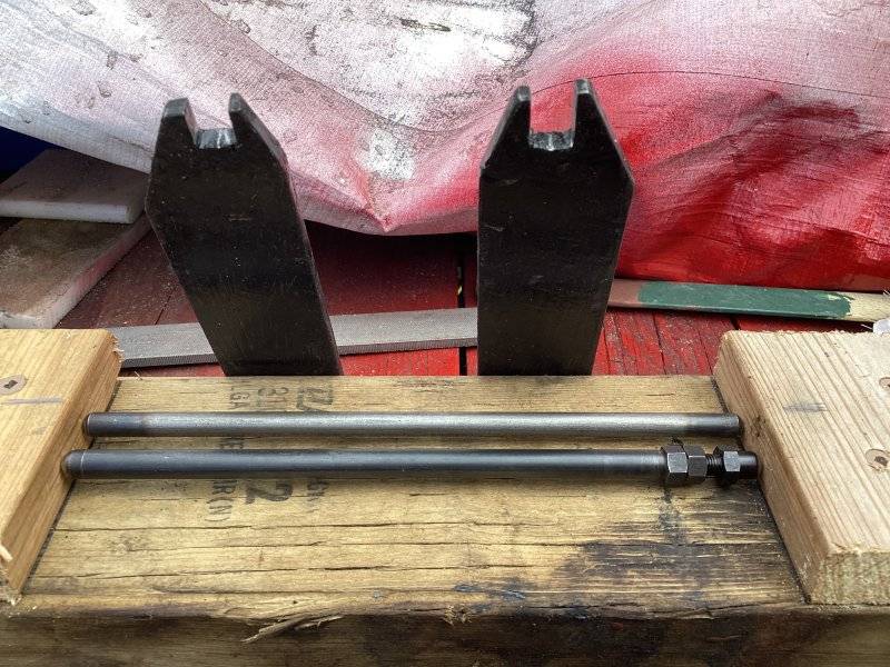

Hydraulic I imagine?Valve lash operation here too. Stock non adjustable push rods were making too much noise. 318 was running fine. Just valve train noise. Doug sent me adjustable push rods. Put them in today. Started with number 8, easiest to get to. Pushrods are easier to turn with the nuts on the end. So I set them just snug, then added 30 thou of length. They are now tight and do not turn. I made a measuring device to set the new pushrods the stock length. And made a couple of spanners to snug the locking nuts. Should finish this job, and fire tomorrow.
Yes. New cam, hydraulic lifters, cam gear and chain, valve springs, inlet manifold and carb. First time for me with non adjustable valve gear. But is is adjustable now.Hydraulic I imagine?
So you adjusted them all to the size of one cylinder?Yes. New cam, hydraulic lifters, cam gear and chain, valve springs, inlet manifold and carb. First time for me with non adjustable valve gear. But is is adjustable now.
