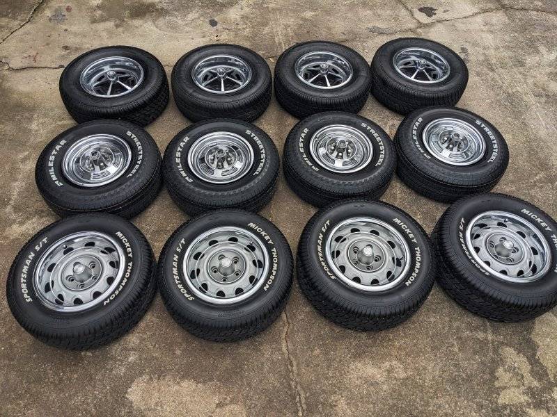

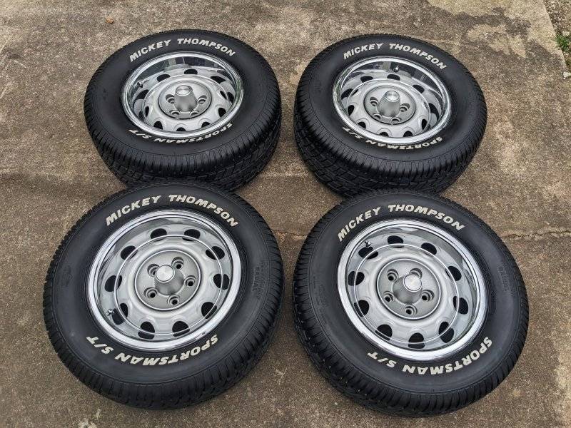

Not B-body, but I have B-body tire and wheel stuff coming up. Two sets of new tires. Prepped painted, and detailed. Soon to be installed....

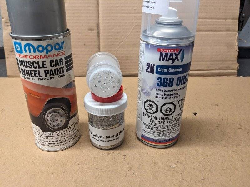

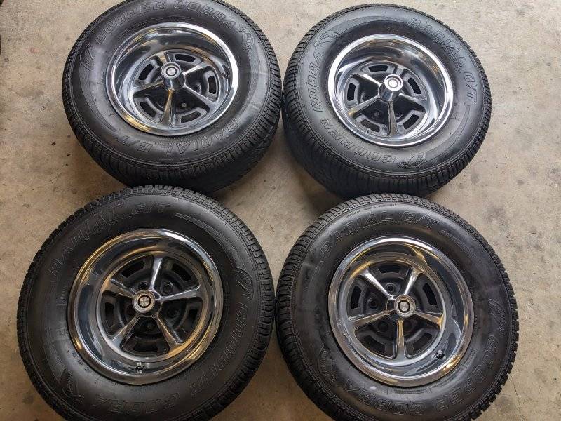

15"x6.5" 3699066 wheels with 235/R60-15 and 255/R60-15 for my 1973 Twister. Originally repainted in the 80s, I repainted the wheels with my last can of Mopar Performance P4529876, argent silver Rallye wheel paint, top coated with 2K clear.

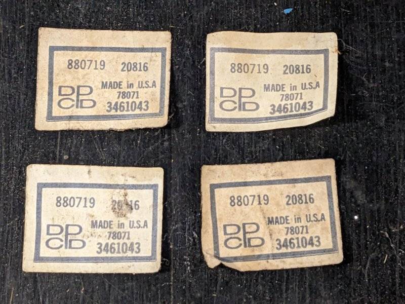

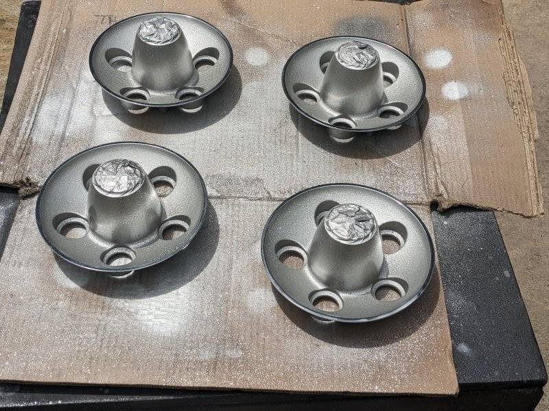

I bought the trim rings, #3461043, and center caps new from Chrysler in the 80s. The caps, or domes, were dark argent, but I repainted and flaked them in light argent, then top coated with 2K clear.
The original stickers on the trim rings finally came off after 40 years and a lot of miles.

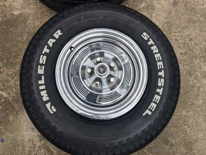

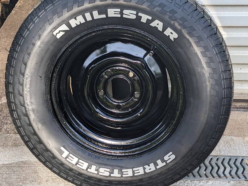

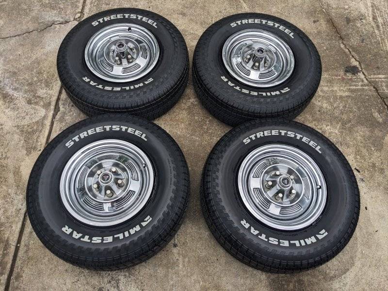

14"x6" 3580060 wheels with 225/R70-14 for my 1970 Duster. Already painted 20 years ago, I re-sprayed the wheels with black catalyzed acrylic enamel.
The wheel covers are 1965 Valiant/Barracuda that were on my original 1970 Duster I bought in late 1975. It had 14"x5.5"wheels with small lug pattern and the long lug nuts that stick through the wheel cover. My replica Duster has late A-body disc brakes with the large lug pattern, so I added some dummy stainless steel nuts and washers affixed with bolts to the wheel cover to simulate the original look.

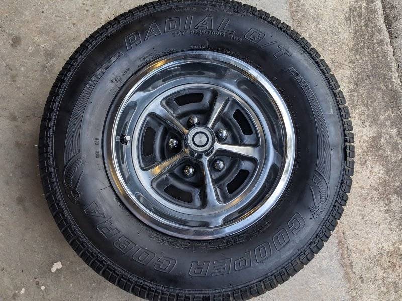

The 14"x6" 3699331 five spoke road wheels with 225/R70-14 are an alternate wheel/tire for my 1970 Duster.
Very nice detail work. They look great!

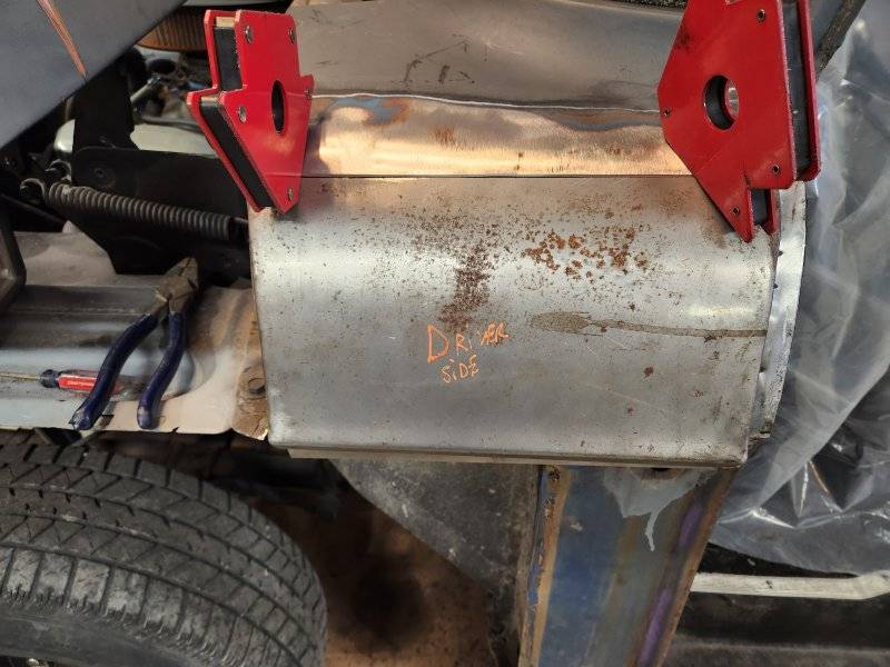

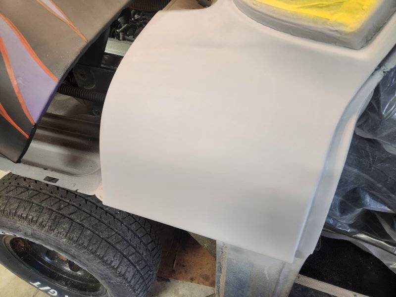

Now on to the driver's side:
Roughed in - no filler yet, did I say I'm not a body guy....I have found a new appreciation for the guys who make this look easy.

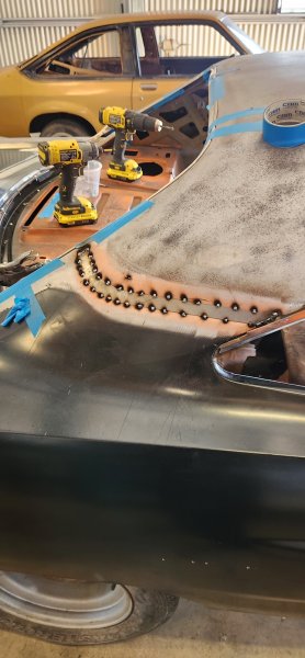

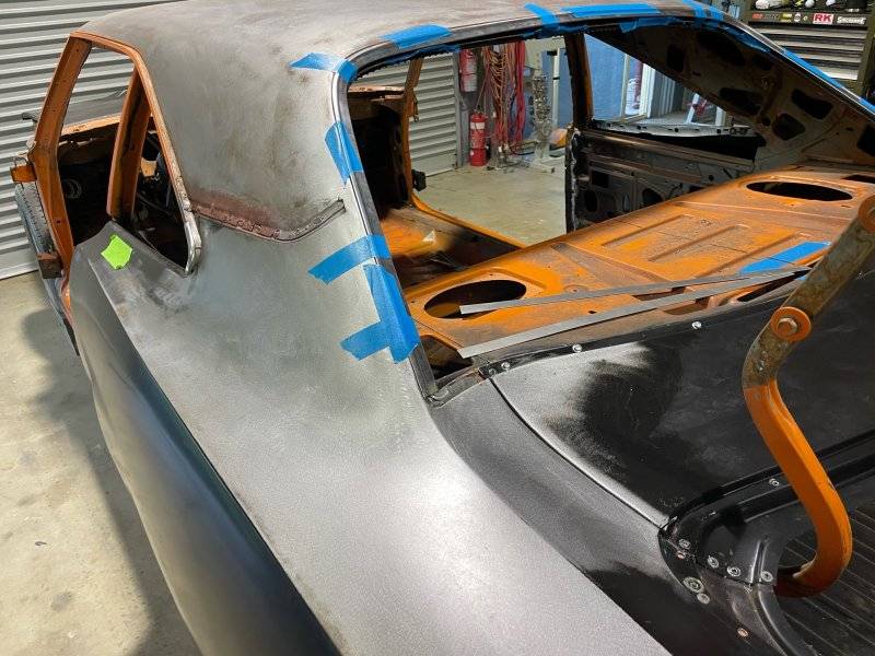

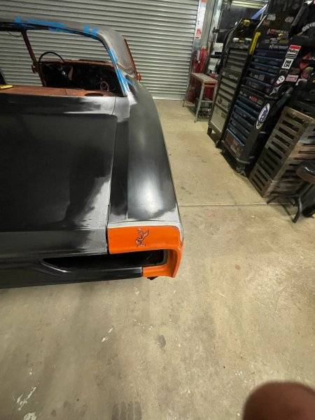

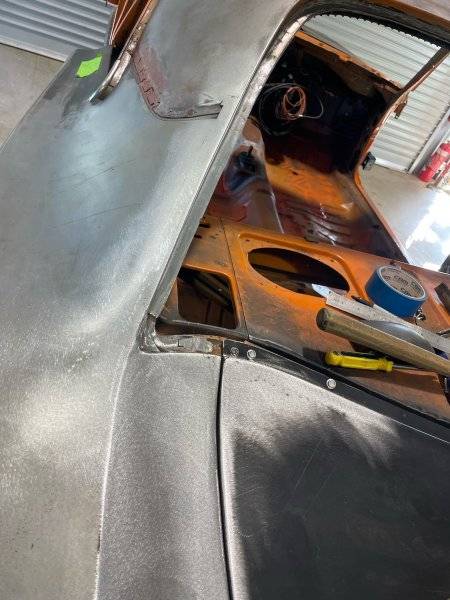

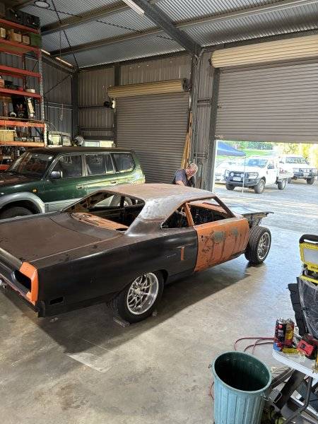

Nice to see the roof seam fixed properly :thumbsup:
My panel guy removes all lead filled seams, cuts the top panel away, treats rust from the tinning acid, welds in new sheet metal and then welds in a filler strip over that, even if it shows no sign of issue, you could say he is OCD but I’d probably then add another layer of OCD on top of that again, his metalwork is ridiculously good, not cheap however I rest easy knowing his attention to detail
We got the same guy up here!
