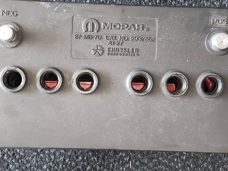

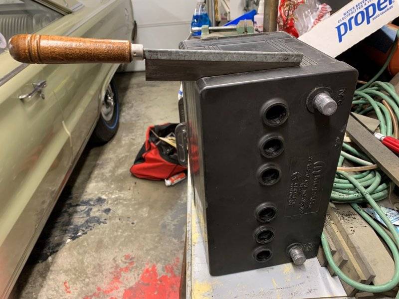

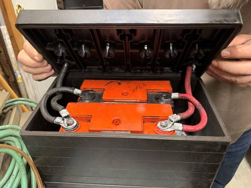

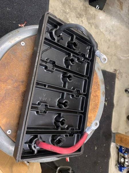

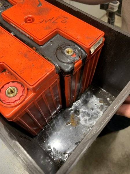

Trying to change the lithium (corr. AGM) batteries inside a used repro battery.
Used hobby Zona saw to cut between the thin gap between top cap and base. That makes a very thin and accurate cut.
It looks like these things are set in 1-2 inches of potting epoxy. I guess to keep them from moving around? Seems excessive.
