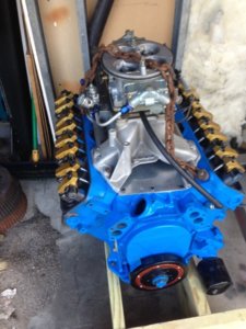

I run a girdle on my 440 w/ main and head studs. Also have the smallest piston I could get with the combo. Right at .000 deck and will be about 13-1 cr with the trick flows.

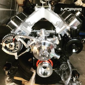

Mines a 12:1 victor head around 700-750 range. Girdle, eagle crank and rods, mahle pistons, girdle. I’d say go for it, should be fine if it’s assemble correctly! Hope to see you guys out at 41 next year!
FCD66640-0F95-4CE4-BCEC-AD511ECC7B28.jpeg 2DC38AE1-9B16-4946-9C08-E37A493BC394.jpeg
