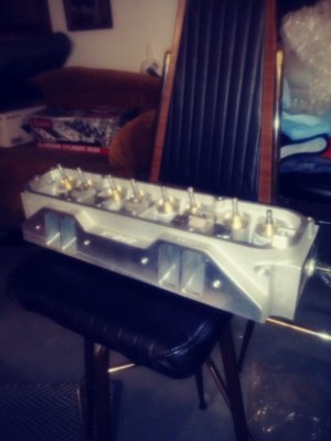

I figured it was a given that when you put the -1 heads on that you opened the 2D up to MW size.
I don’t see the point in running MW sized heads with a std sized manifold on them.
IMO there are two suitable intake choices for you...... the 2D at MW size, or the 337.
Seeing as finding a 337 is impossible.
How much we talkin to have ya open up the 2D to max wedge?
It’s really not much work....... you could easily do it yourself.
The intake is designed for that to be done.

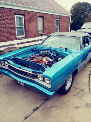

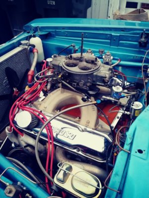

this is what i'm doing,along with my new indy tunnel ram,,,what tire do i get that will look like this on the street?,,those meats r firestones,33.5x15x15's on weld 15x13's with a 5" b/s.its what the car rolled in on,,the look was 1 reason i bought it..
...wheels r fine..just what tire...

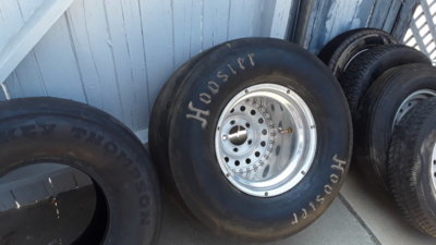

@stage3, try hoosier quick time or quick time pro. Quick times have a tread pattern, pro's are dot slicks with three grooves. Quick time 31-18.5 are 18" section, 31" tall, 15+ " on the ground. Pro's are the same, except 31 or 33 tall. Either one around $300 each last i checked. Tube or tubeless.
I'm using the 31- 18.5 x 15 on my opel.
this is what i'm doing,along with my new indy tunnel ram,,,what tire do i get that will look like this on the street?,,those meats r firestones,33.5x15x15's on weld 15x13's with a 5" b/s.its what the car rolled in on,,the look was 1 reason i bought it..View attachment 702310 View attachment 702311 View attachment 702312 ...wheels r fine..just what tire...
Show us some pictures of the rear suspension please....Picture kinda shows leaf springs with those really, really big tires.
How in the world does the car have such tire clearance with leaf springs...or has it been back halfed with leaf springs, not ladder bars...please let us know.

thanks for the info,,,the funny thing is the firestones section width is narrower than the m/t's by 1"...hoosier says there quick time tires r not for street use and marked on the tire,,,i'm looking at the m/t's et street bias ply tire in the same size of 31x16.5-15..31+ diameter,16" section,and 13.39" tread,,which means the tread will be around 14" with tubes.a direct replacement to the firestones..they advertize them as street legal,,,here in taxifornia,1 has to be careful,,

some body decided they wanted pro stock size tires on there b body...its been back halfed with leaf springs,and i added cal-tracs bars,dana 60 was custom sized to the wells...which measure 20 inches..and the 4.56 gears offset the large tires.it had 5.13's..at 65 mph , its taching 3100 rpm's going down the freeway..it scares the prious drivers when i blow by them at 75 down the freeway,,,has a vibration though at around 65+ and up mph?
Stage3, now you gonna make me look! I've been using mine on the street in cali, and i know they are marked dot. And LT for light truck tire. Now i'lll have to look when i get home for a prohibition on the tire. I'm out of town till tomorrow.

@stage3, I just got home and looked at my tires. The M/T street radial PRO has just a size , and " for drag racing use only, not for highway use" in big letters, even though it has a DOT number.
My Hoosiers have a DOT and a LT designation, and NO prohibition for street use. Therefore street legal.
Hoosiers recommendation not to use on the street may just be a cya, like M/T recommended absurdly high pressures in slicks, to keep cars from swaying a little from low pressures, never mind that they won't hook.

slick lookalike,,same as those big meats on there now..just came back from ET wheels in fremont..they r cutting my wheels down to the same size as pictured above with the fire stones...the m/t et street tires r very close..thats probably what i will go with..thanks.

u cant be too careful..hoosiers website says not reccomended for street..like u say cya? i'm looking at the m/t bias tire which is recommended for street and will give me the look i'm after..
