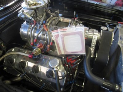

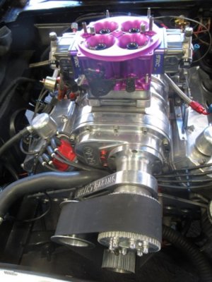

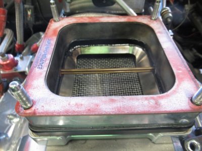

I will be adding nitrous as well but just for it's intercooling ability. I will lower my IAT by over 100*. Also thinkin 1 or 2 fogger nozzles into my 1 inch spacer under the cars. I bought a pair of spray bar plates but the throttle blade hits them. So it's parimeter plates or fogger nozles into the spacers..............:BangHead:
Go fast is came a long ways and engine timing and the time release of each fogger is most important to a fast ride. The best I can can advise is read and build your system first on the table so you have everything correct. Make sure your program is correct and it also has a manual shut down or overide in case of issues. But I would think that with your setup and the hp you will have you should just kick *** on the street.

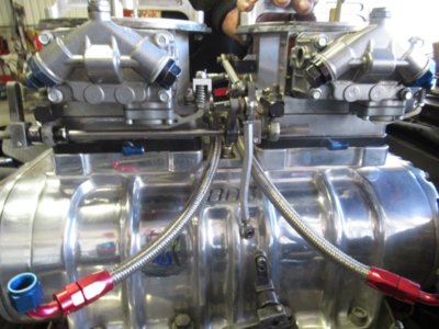

Actually I have a picture of what I believe is the factory aluminum 6bbl intake plumbed in a similar manner.

Sweet looking setup but unless you are able to hide the rest of the system why worry if everyone can see it. Would not want to pull intake off all the time. Just my two cents. Have a great Thanksgiving
