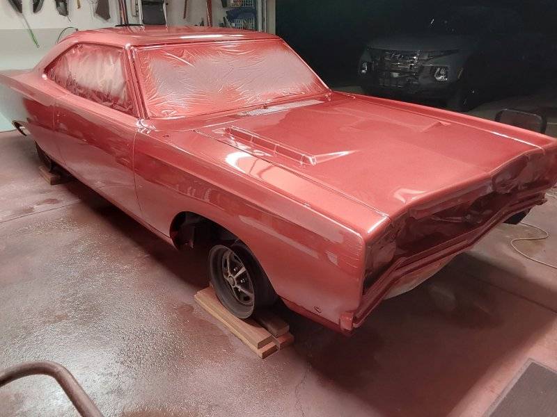

Painted my 68 today mm1 turbine bronze using acrylic enamel, over all came out pretty darn good. Metallic laid very nice.
