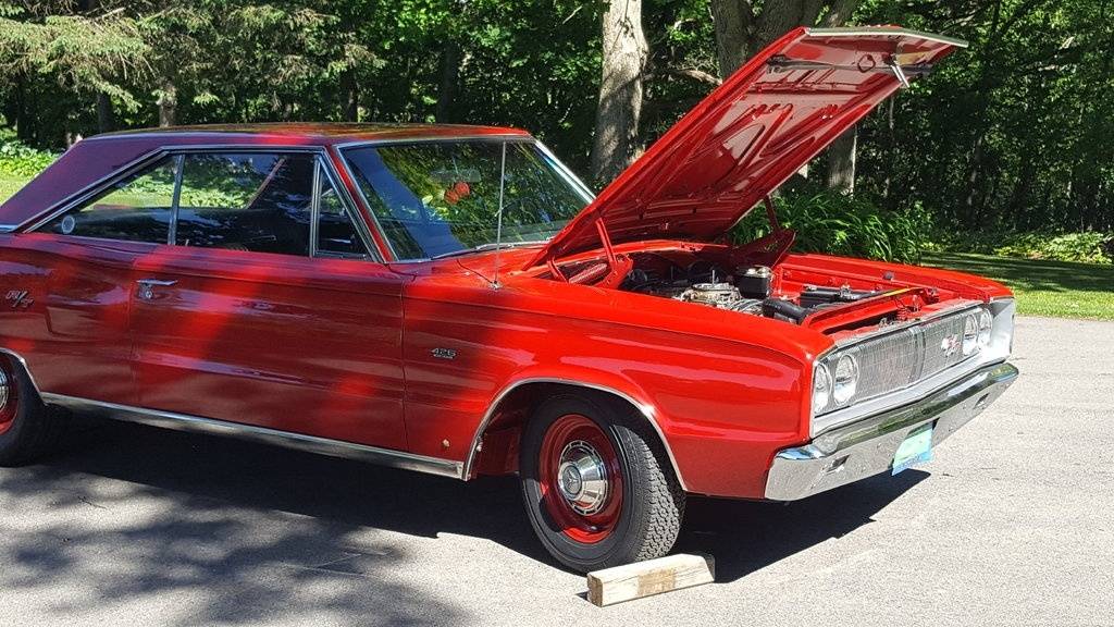

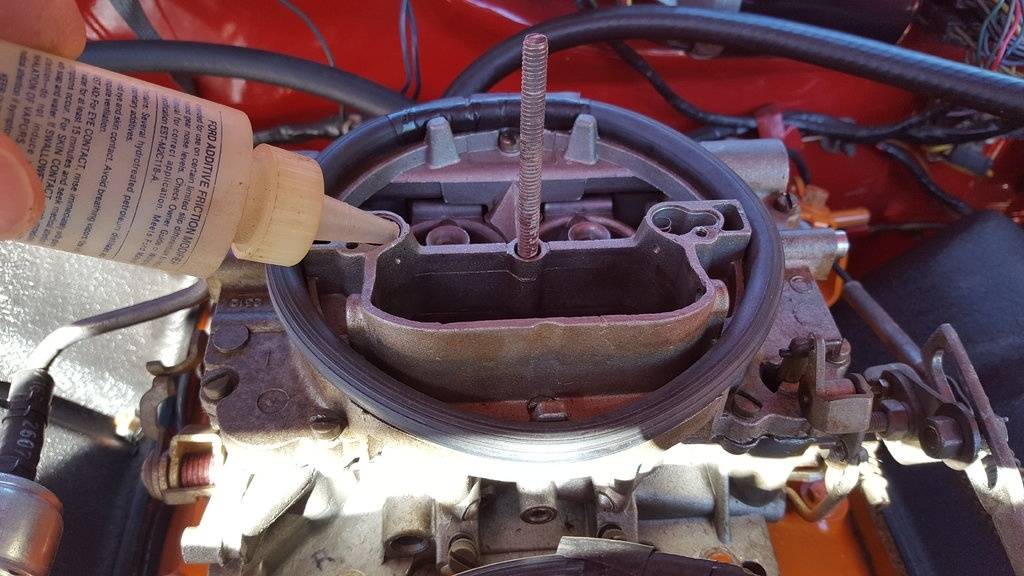

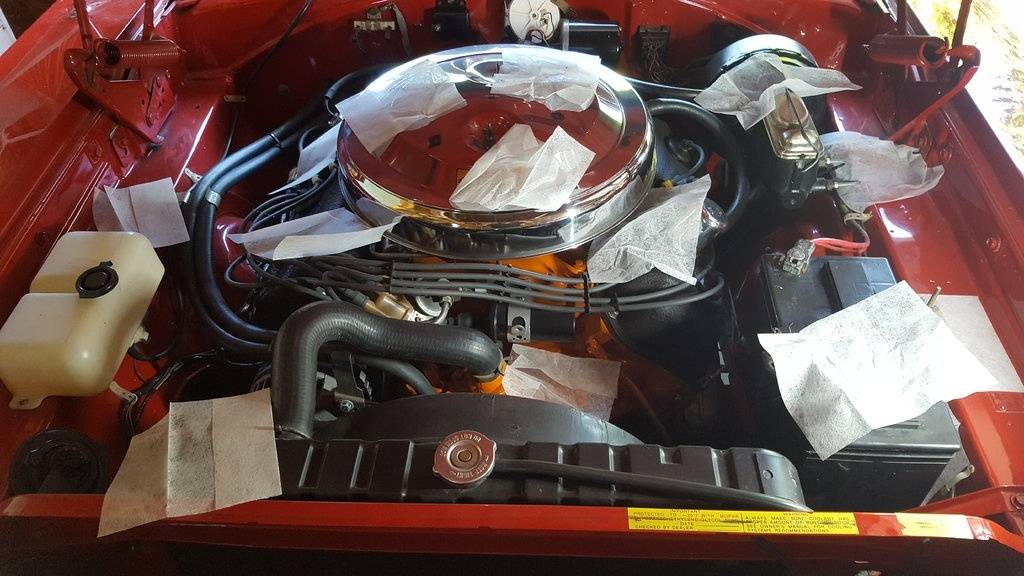

Finally took a break from the 65, and dug out the Coronet. Its time to do some driving! Have a few things to do first. I usually push it outside for the restart. Remove all the mouse proofing, pull the metering rods to fill the bowl on rear carb. Once the squirters are primed, I give her about a dozen pumps, and bam.....she lights right off every time! Not a fan of countless cranking to get the fuel up to the front. A check of the guages, we are good. Now break out the Brad Penn 20-50 , and a filter, and good for another 4 months!

Very nice car. Love those old Hemi cars. Curious as to why you pull the metering rods to prime the carb? Those rectangular openings to the outside of the metering rods lead directly to the fuel bowl. I just stick a nozzle from a priming bottle in them and squirt some gas in there and then a little down the primaries and hit the key and it fires right up.
Yah know, ..... I guess i never put 2 and 2 together. Why do things the easy way, when the hard way is so much more challenging!! Double Dah, on my part. Every day is a school day! Thanks!!
Nice car. Mice makes nests outta dryer-sheets around my place.
