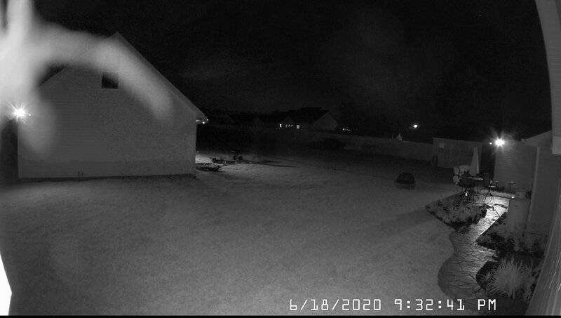

Here is a shot of the rear camera last night. The light you see on the garage and house on the right are other cameras. You cannot see the lights with the naked eye. I do not have that particular system but I have recommended it to neighbors and it will produce the same results.
That is an excellent night picture. That's how you tell if a camera is any good. Daytime all cameras have good pictures. At night the cheap cameras will have a hazy, or ghost like picture, blurry. A good camera will have a good clear picture at night.

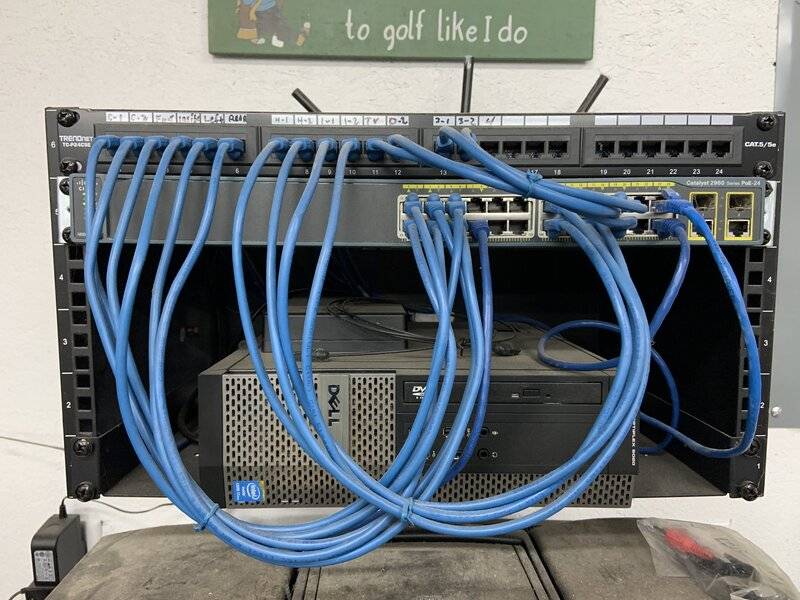

Mine is not a prepackaged system. You can get the same results with one like I posted and that is the way to go for most people. My system runs Blue Iris software on a PC with an external 6TB drive for storage. I bought used POE Cisco switches on ebay for about $25 each, and the cameras are 4mp domes from Amazon like this.
https://www.amazon.com/Dahua-IPC-HD...dp/B07C5QVZTQ/ref=psdc_14241151_t1_B07LF88Z8Z
The left half of the switch is the camera VLAN and the right is garage data.
