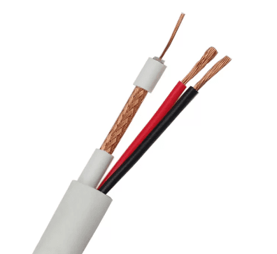

The issue is more to do with induction interference from AC cabling, which is the typical mistake a non-electrically minded person would make. Cameras are typically powered with ELV DC - as in 12 Volts DC, and sometimes 24 Volts DC. DC voltages do not induce inference that AC cables do. Hence why camera companies use composite cables in some situations - that is "Coax plus power" in a combined cable sheath....as shown below
Cat 5 & 6 cables do have reasonable protection from outside influence, but it is always prudent to maintain at least 300mm (one foot) separation on cable runs between AC power cabling and data/coax cables. Another factor is length of cable run with coax cabling. Anything over 100 metres (110yds) and you start to lose data transmission strength....fading, picture loss and quality become an issue. Even up-sizing to a larger coax cable will not help much.

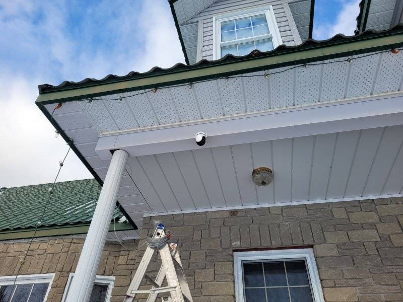

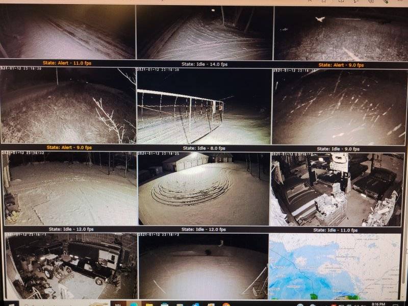

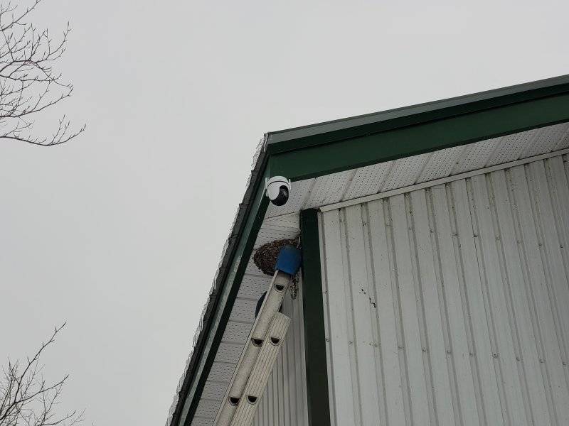

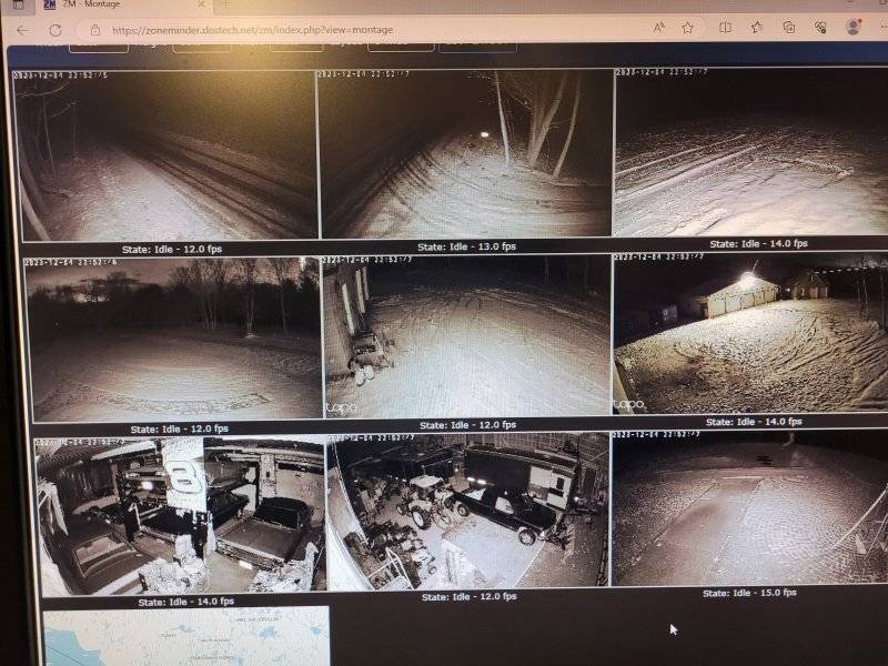

My cameras have mini SD cards in them. They continue to motion track their full 340 degrees with the ithernet down and WIFI down and still record. All they need is power and the majority are on our battery back up units that keep our point to point antennas, server and computers from power bumping.
Best part, they only cost $75 Canuck bucks each delivered to the door!

View attachment 1589061View attachment 1589062View attachment 1589063
Wayne, are those Lorex brand cameras?
