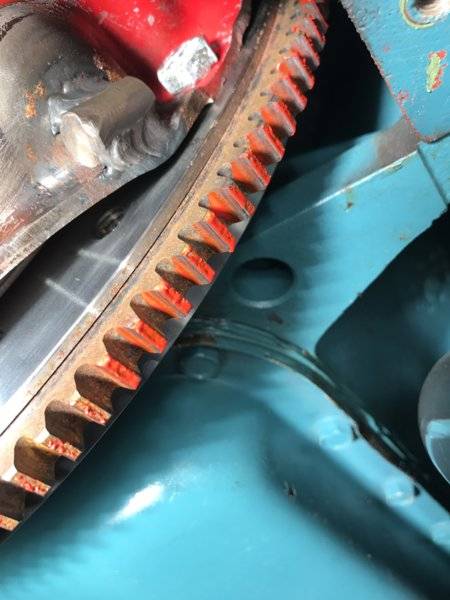

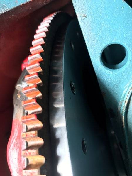

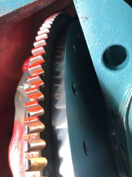

Can I recommend you wipe the gear and fly wheel teeth with Dycam blue. Them run the starter and look at the pattern where the blue is worn off. Takea picture of it and send to rob to look at.

Some pics of the tooth backslash pattern:

You cannot change the relationship of the ring and drive gear on a mopar.
The starter locates in a register in the bellhousing. There is no backlash adjustment.
The only adjustment would be a depth and done by shimming the starter to move it toward the front of the vehicle and away from the face of the ring gear.
