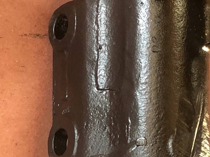

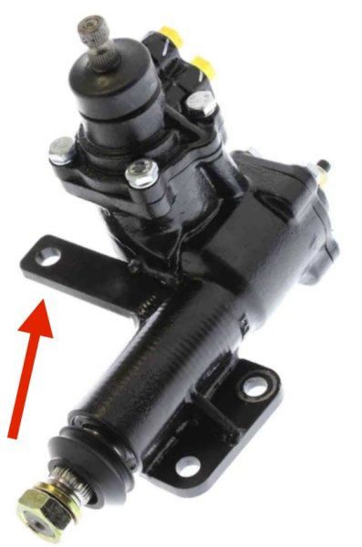

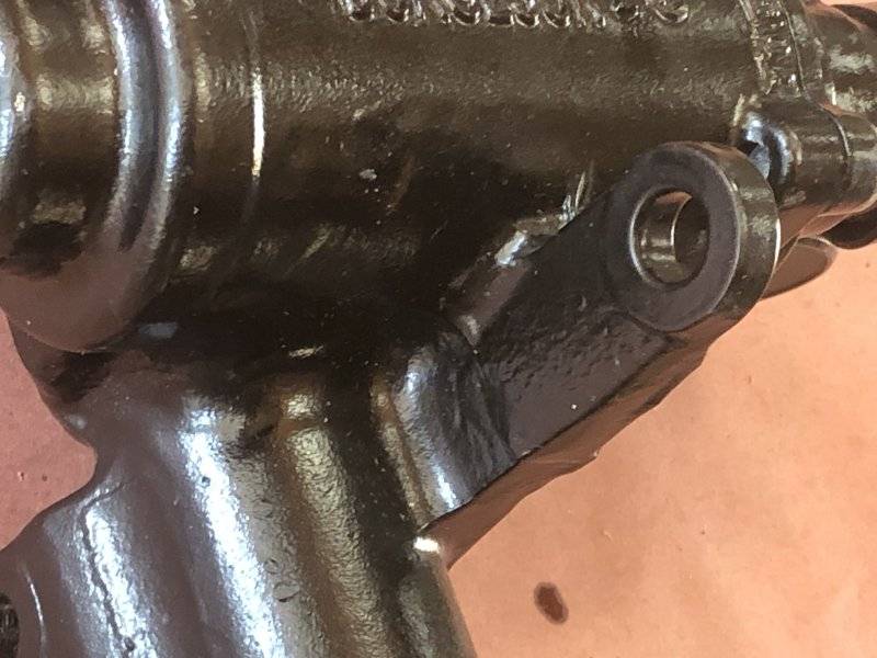

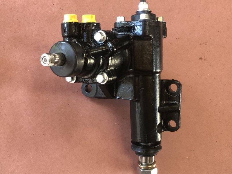

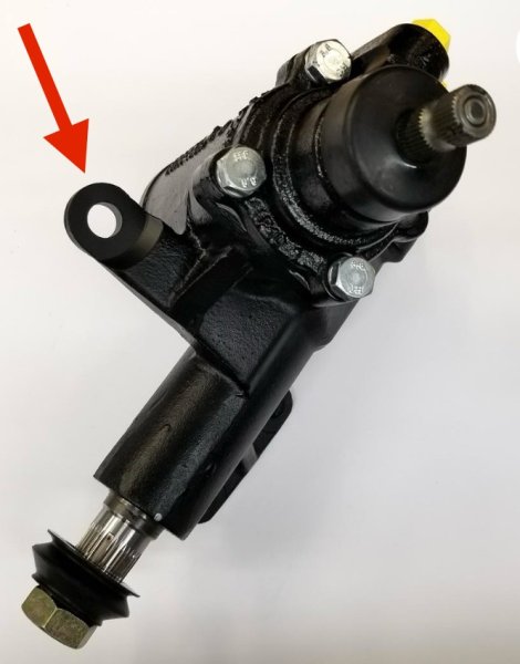

What part of the box is welded? I don't have pics of mine, but I just purchased/installed it last month.Which generation of Borgeson box is making the noise? There’s one that’s welded and one that’s newer that’s not welded.
My friend‘s dad bought the older version when they first came out. Noticed the mounting bracket one has a rounded bracket compared to the square bracket. He’s not getting any noise or hiss from his.They both look welded just like Greg’s above.What part of the box is welded? I don't have pics of mine, but I just purchased/installed it last month.
Mine is just like Greg's.My friend‘s dad bought the older version when they first came out. Noticed the mounting bracket one has a rounded bracket compared to the square bracket. He’s not getting any noise or hiss from his.They both look welded just like Greg’s above.
Ive ran the old box and ive got a 24 box also. My old box hissed like a snake and leaked oil. I replaced the old box and pump last year and its alot quiter than the old one. Ive never experienced any belt squeal with either one. Anyone with extreme hissing ive been told wrapping the column with like the leather baseball bat grips will quiet it down. IDK.My friend‘s dad bought the older version when they first came out. Noticed the mounting bracket one has a rounded bracket compared to the square bracket. He’s not getting any noise or hiss from his.They both look welded just like Greg’s above.
