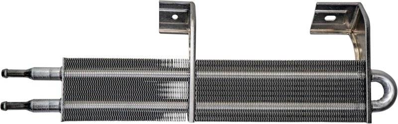

I would definitely do a cooler. I used a trans cooler from a 2000's Ford Ranger. It's stacked plate design, has a nice mounting flange and was much cheaper than aftermarket. I mounted it to the support in front of the radiator to get good airflow.
Was going to try to do something in the engine bay but that's not a bad idea...

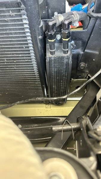

I bought this one off of Peter Bergman and mounted it right beside my AC condenser
not a bad spot.. i can't really put anything in front of my radiator.. so thinking of ideas.. there is one that's bout a foot long i could put on the inside of the drivers frame rail.. would still get plenty of air..
Yeah, mines about the same length. As long as you feel like its getting plenty of air. I scraped a few bugs off of mine before I took the pic lol

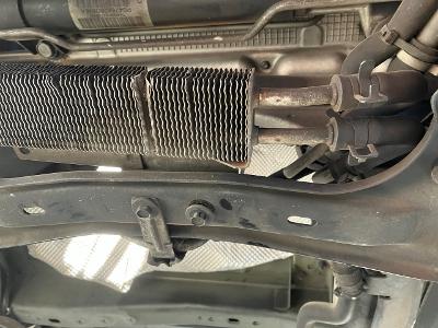

These coolers are simple. I pulled three from a junkyard for $40.
Mopar Minivans have them mounted to the front crossmember behind the rack.

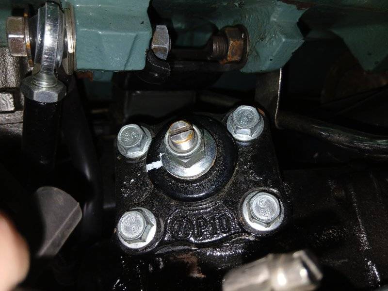

Just to be sure, the lock nut at the adjust screw is loosened counter-clockwise, right?
Its like Hercules tightened it.
