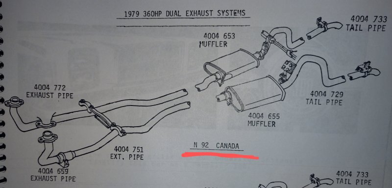

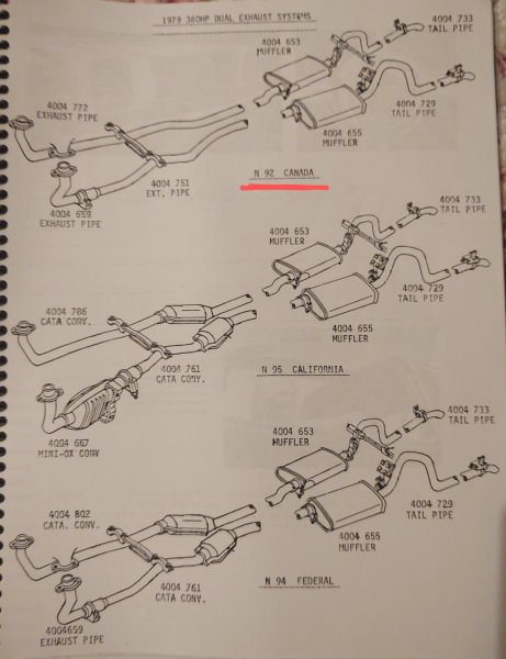

Here's what I have for 1979 Chrysler 300 with dual exhaust:
N92: Canada and Export Emissions Package: non-catalytic, unleaded fuel not required, air pump supplies air into both exhaust manifolds, bimetallic, heat-actuated manifold heat control valve.
Source:
1979 Chrysler 300 Handbook by Dale Burkhardt and John Veatch. Copyright 1989, All rights reserved.
^^^That seems to answer the question!^^^
