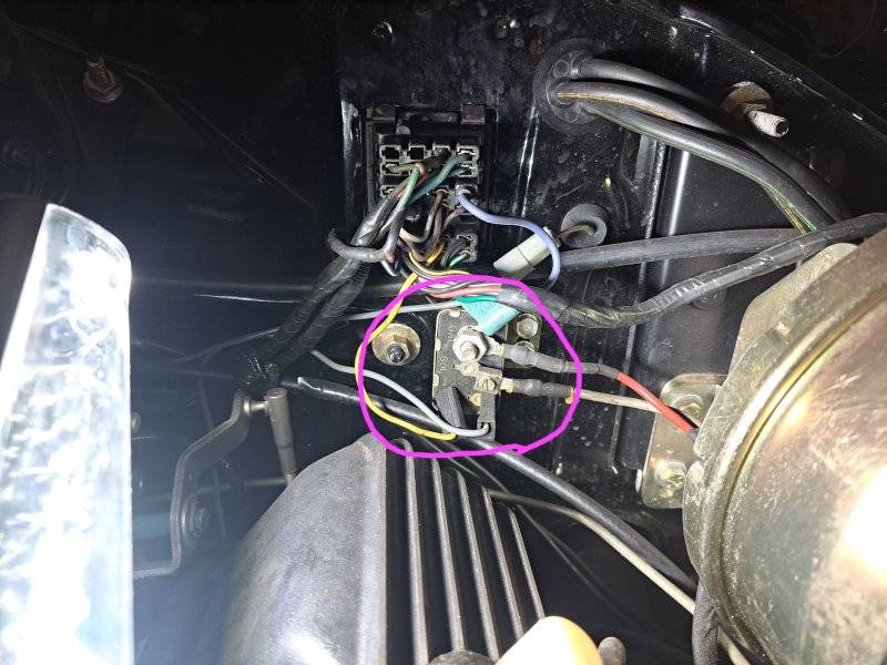

Starter relay? I've gone through 2 so far in as many yrs. If you have voltage at coil, try jumping relay. If it starts n runs, I put money on relay.
I concur. I was told it was "definitely" the neutral safety switch. What I did was apply the e-brake, turn the key to START, hold it there and move the shifter from park to 1st and back again a few times. No crank, no start. Installed a new starter relay and haven't had a problem since.
