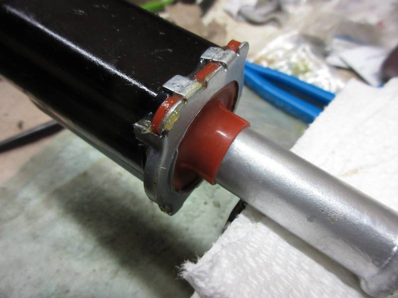

Well I went to put this cover on and I noticed that squeezing the tabs down with channel lock pliers bent the whole cover, and driving them down on one side with a tap and a hammer undid them on the other side. I bent the tabs in a little, but I can pull this off easily and the action of the coupler will pop it off too.

I don't see how that cover stays on, short of welding it in place as someone mentioned. Too bad I don't weld.
