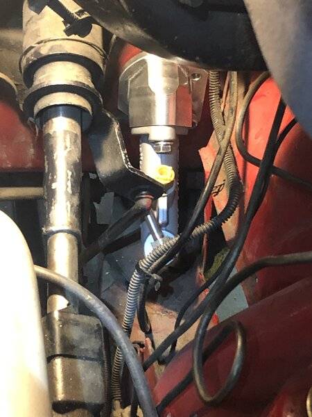

Hmmm...maybe there is some slight angle there, huh?
It looks like the coupler is tilted a little.
Maybe about the same as this one?
Was your alignment as bad as mine?

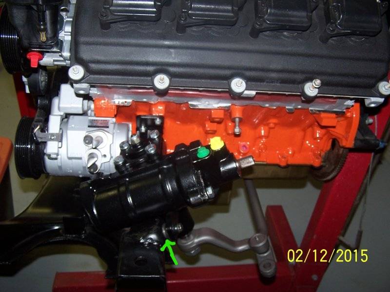

JR, That is exactly where mine was sitting until I added the 1/4" shim as shown in this pic. The shim brought it in line.

In this case it's QA1's fault, not Chryslers. Seems like QA1 could have fixed the problem when they designed their k member?
Is that a shim or a couple of fat washers?
I doubt you'll have any problems, but I'd prefer the steering box to be making 100% contact with the mount instead of just on a couple edges. But, it seems we can't have it all, even when we pay out the arse for it.

Actually, it is a 1/4" thick washer. Can't remember what from but possibly a lower control arm washer. I was thinking that Borgeson changed that mounting and beefed it up some. I know mine is an early version (2014) of the steering gear. The later ones have a gusset welded on that ear that mine does not have. I have about 8K miles on my car since the build. I have checked the tightness of that particular bolt a couple times but it has always stayed tight and in place. It was more important to me that things lined up properly.

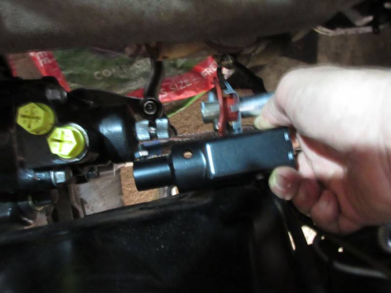

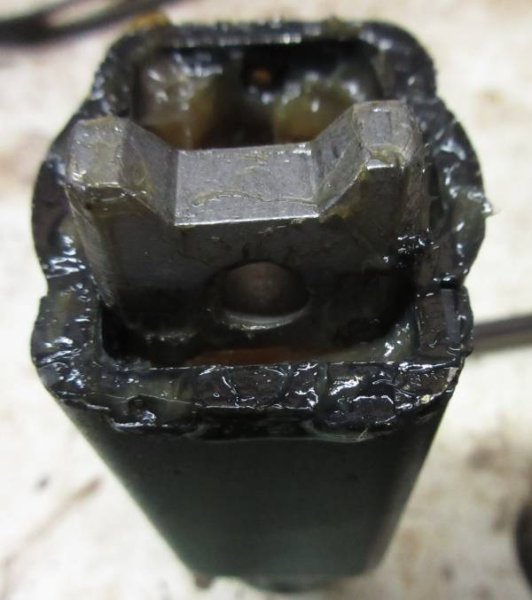

Having some trouble with the Bergman coupler. The track for the shoes isn't tall enough -

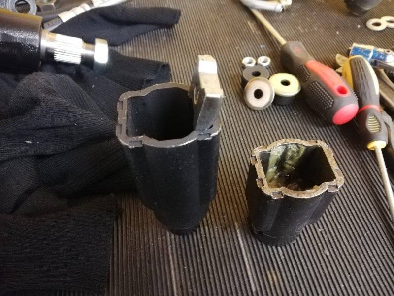

The shoes fit fine in the factory coupler -
Is there any solution other than contacting Bergman and trying to get a new coupler? I must have had this thing for a year or more now. They might not send me a new one. It's the weekend too, I won't be able to contact them for two more days. I wanted my steering done tonight.
Can you take a file to the inside of the coupler to take off a few thousandths?
I used the new parts that came with the steering box kit. I did the same for the 68 Plymouth I just did. Everything fit together snugly with no slop.
Stuff happens though. Maybe the coupler is slightly tweaked and just needs some slight clearancing?
I believe that is one of the new shoes. Bergman's shoes have their own problem - the hole is too small to fit on the factory pin. That's why I didn't use them.
I could try filing the coupler down, but I sure can't file it down evenly. It's going to have a slope to it, and you can't spell "slope" without "slop." Enough slop to notice? I paid for a high quality steering system and that's what I should get. Nothing about the aftermarket coupler should be worse than the 51 year old, 106,000 mile factory coupler.
Same thing here. Does the ones that comes with the kit fit better?
I didnt get the shoe-kit with my box, these are my original shoes.
No, the shoes with the kit don't fit at all. They don't fit in the coupler, and they don't fit on the factory pin.

Isnt it easier to file down the shoes instead of inside the coupler?
No instructions. I did read some instructions on the webpage though.
Easier, yes. Probably what I'll end up doing. I was hesitant because I don't want to destroy the finish on the shoe, but the grease should protect the bare metal after filing.
I need to figure out some good garage-trick to file them down flat...
Putting them on a file like this and they will look like a banana.
That's how I was going to do it. But I will contacting Bergman first. It's been so long since I purchased my coupler though, they may not feel like replacing anything.
