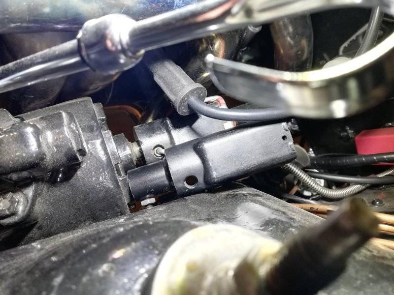

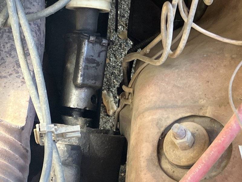

Something I didn’t think to ask:
What position is the coupler supposed to be with the steering wheel at center? I have cars here with the coupler in a variety of positions.
Does it matter? I don’t see how it would but I’m not sure.
Here is the Plymouth.
My ratty Jigsaw Charger. The roll pin hole is right of center.
Ginger, my other Charger with a Borgeson box.
Hard to see but the roll pin hole is to the left of center.
My 67 Dart.
The Dart coupler is like Jigsaw.
Anyone know if this makes a difference?

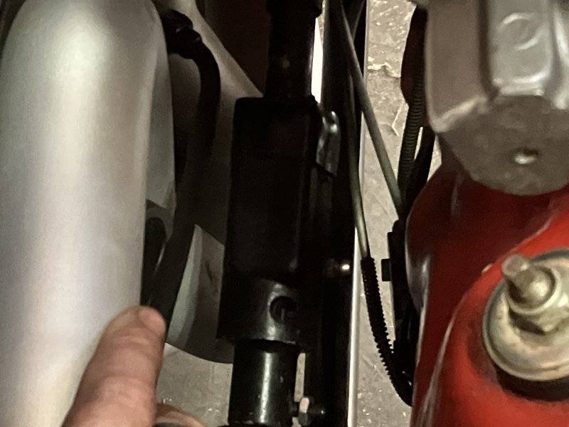

My ratty Jigsaw Charger. The roll pin hole is left of center.
Hard to see but the roll pin hole is to the right of center.
My 67 Dart.
The Dart coupler is like The Plymouth and Ginger.

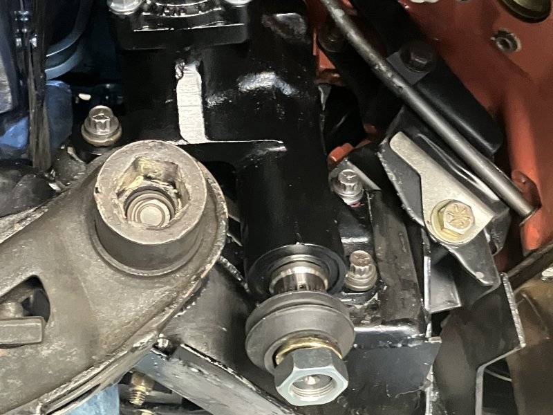

I got the steering box installed in the cuda, small block 340 super easy slid stock box out thru the bottom and actually slid the Borgeson thru the top. Nothing in the way, did not remove anything. Waiting for the no cut style coupler, pulled the steering column out and had the same vanishing coupler at the bottom of it, talked to Peter and he's throwing in a replacement bearing in the shipment that they sell that will
eliminate that issue for good. Should be here end of the week. Way cool guy, very customer service oriented. Something that is non-existant with alot of companies today.
The exhaust manifolds make a huge difference in the ease of steering box accessibility.

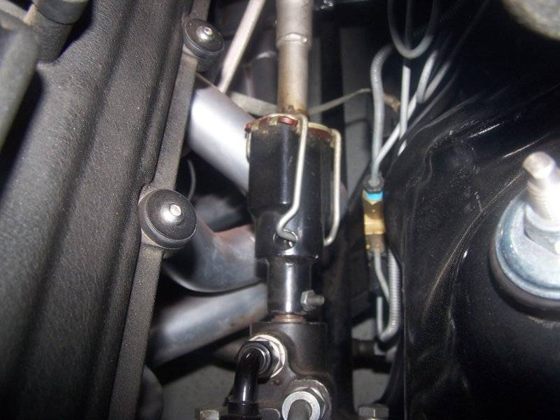

Those thin sheet metal rubber seal retainers are often a problem for me. This car had one of those cool wire type retainer clips....
It lays over the sheet metal retainer and keeps tension on it.

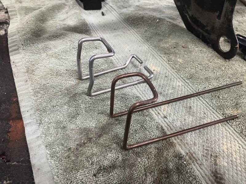

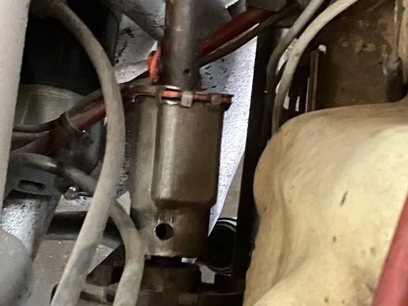

Here is the problem. The Bergman coupler is longer and the roll pin hole is 1/2" further away. The roll pin hole is where the ends of this wire retainer slide in.
The fix?
Either use a neoprene boot like so:
Or get creative....

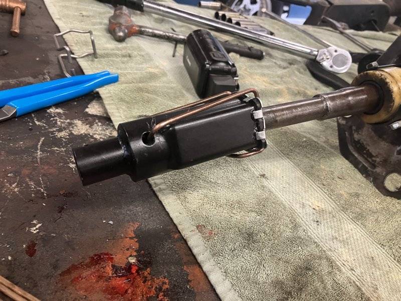

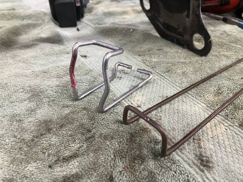

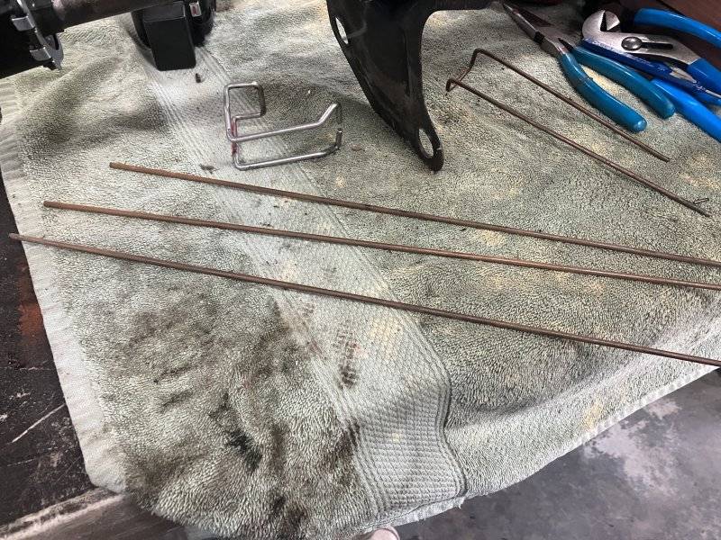

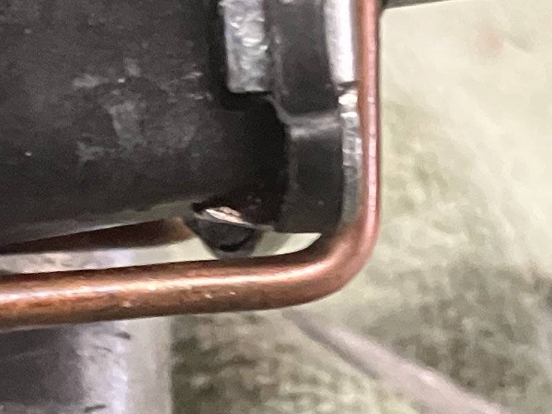

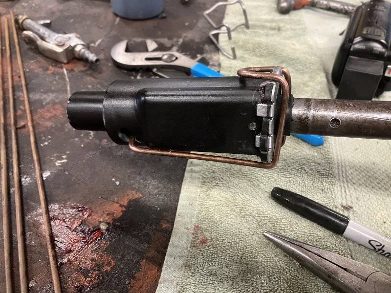

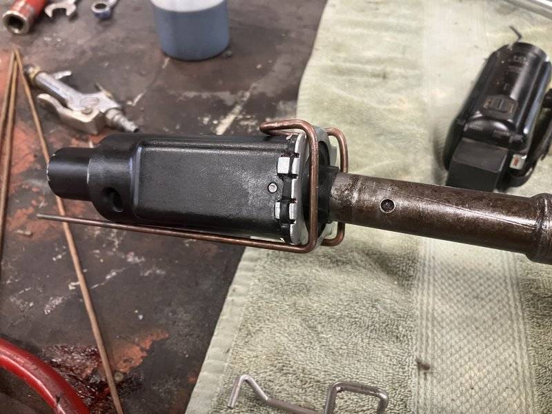

Just to see what I can mock up, I took some welding rod....
Made a few bends using the bench mounted vice and pliers...

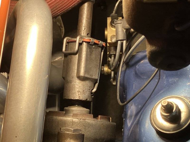

Test fit....

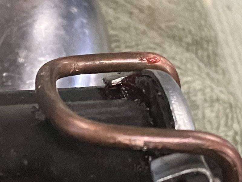

Then the bends to fit into the roll pin hole that isn't used with the Borgeson unit.
Not perfect but I think it will work.

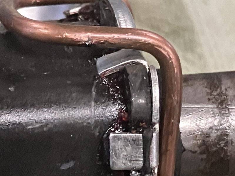

I was able to bend the tabs on the steel retainer piece to get a better grip on the coupler.
It looks like this might work.

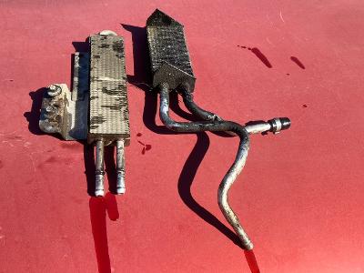

At this point, the column can go back in and tested. Just a few small details to address. This car had no inline PS oil cooler but I have a few used ones I pulled from Dodge minivans awhile back...
I have three similar to the one on the left. Very simple. Now, where to mount it?
Test fit....
Why is your Bergman coupler so long? The one they supplied me back in 2014 is the same length as a stock coupler except for the added stem to compensate for the shorter gearbox. The stock retainer worked just fine on my Bergie coupler.

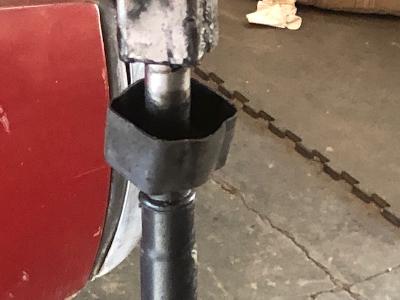

My 67 Dart.
It does matter if you want your steering wheel straight and level at zero. Since the Borgie gear is not clocked, (at least mine wasn't) it is a bit of a chore to get it right. I thought I had my gear box at zero and lined up my steering wheel when I slid it in place but it was off a couple cogs. When I got it where it needed to be, I marked it with a center punch in case I ever take it apart.

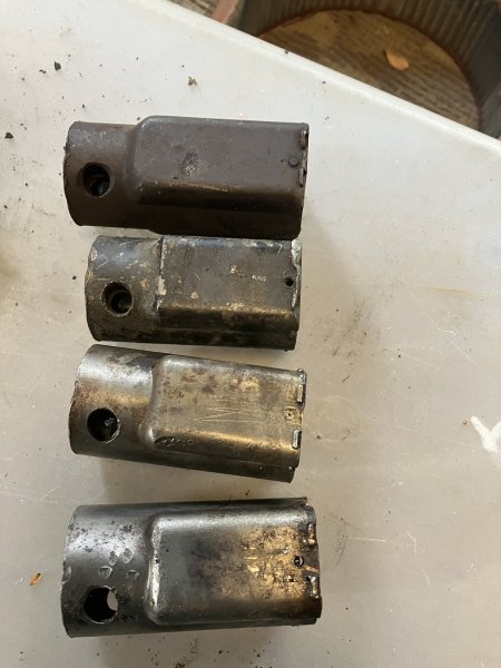

I've noticed that the original couplers have had a variety of lengths.
The early A body ones were the shortest of all that I have seen.

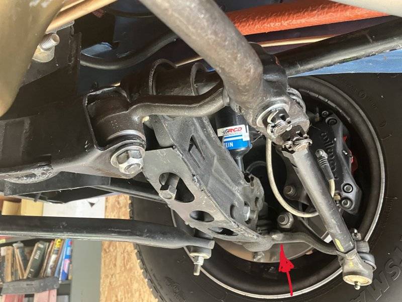

For my red car, the tires touch the frame rails before I can make any full 1 7/8 turn from center. The lower ball joints in these cars have those nubs that limit travel as well:
KD, When I bought my 68 Charger and stripped it down, I noticed the front tires had been rubbing on the frame rails too. I figured it must have had some wrong parts or something but never really thought about it. It had 14" wheels and tires at that time. I now have 15" wheels and tires but no rubbing. I didn't even remember it until you mentioned your tires rub. My suspension is pretty much stock except for larger T bars, adjustable strut rods and sway bar end links along with the Borgeson steering gear.
