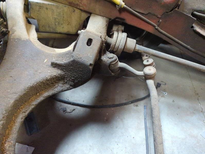

I managed to remove my old steering box from the top by loosening the engine mounts and lift the engine as high as it would go.
