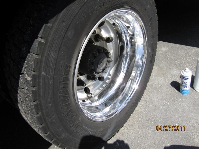

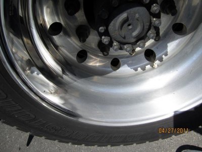

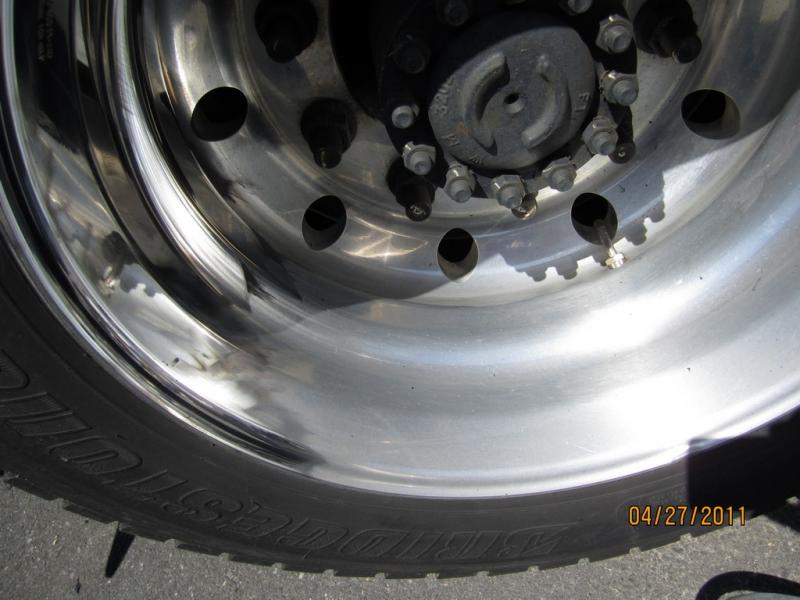

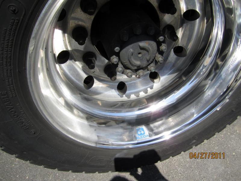

I have gotten the hang of aluminum polishing between my tow truck and the car,there is alot of bling maintainence.I will try the easy off,I read a thread about a guy that sanded a grille & surrounds by HAND,then polished them.
